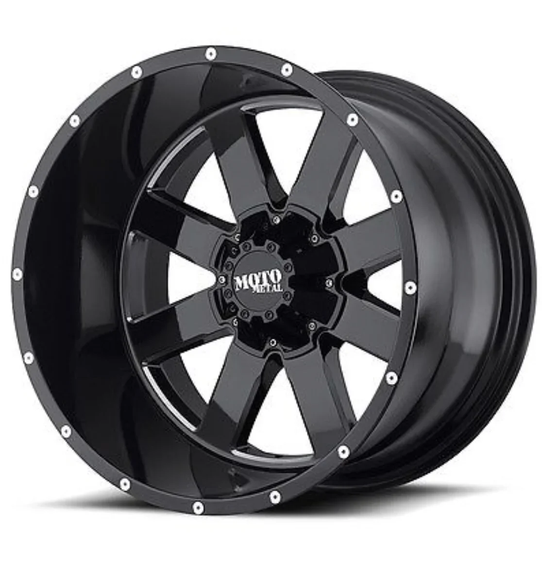

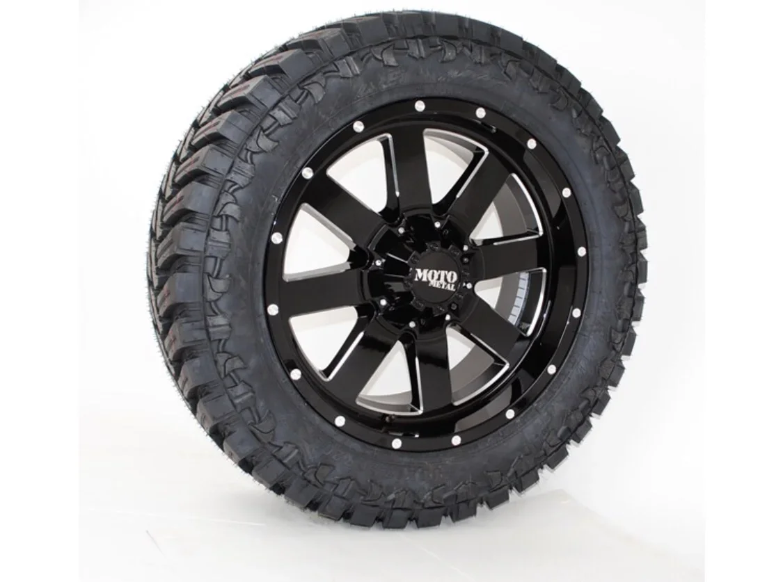

Next question or17trd...as far as a 0 offset goes...does that make the bowl/deep lip more on the inside of the wheel or the outside? I just don’t want to order wheels and have them look the opposite of what I want
Offset of 0 means it’s equal. You should have the same distance in “bowl/deep lip” a negative offset would cause the “bowl/deep lip” to be seen more on the outside. Like your first “I want” picture. A positive offset would make the wheel look like your second “I don’t want” picture.
