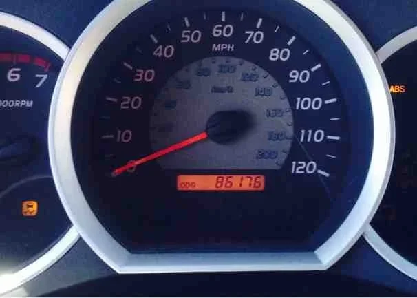

Joshuarubin09 Well-Known Member Jun 8, 2014 #1 I have these two lights on my dash. What does it excalty mean?
whippersnapper02 Negative Nancy Jun 8, 2014 #2 The ABS ECU has detected a fault so ABS and traction control/stability control is off. Did you do any work to the truck?
Joshuarubin09 Well-Known Member Jun 9, 2014 #3 I haven't no, though when I got it, it came with a 3inch lift on it. But these two lights just came on the other day. I have had the truck for about a year now.
whippersnapper02 Negative Nancy Jun 9, 2014 #4 Check your sensors or get a code reader that is capable of talking to the ABS computer.
Joshuarubin09 Well-Known Member Jun 10, 2014 #5 The weird thing is, it turns on then off. Now it hasn't been on for about a day or so.
