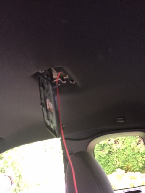

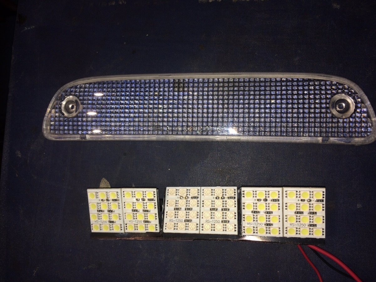

Yup, bought the led panels off eBay, the clear lens was the most expensive part. Wired the cargo lights to the dome light and used the original brake light wires for the high mount light brake light. Really was an easy job.
