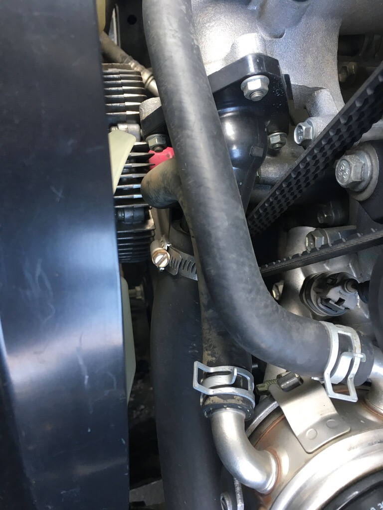

It's just a drop or two coming from the lower radiator hose. I've left it as is because it isn't bad yet and I was seeing if it was actually leaking or a fluke because it's a pain to get to. The supercharger belt drive needs to come off.
The right outlet of the coolant manifold:

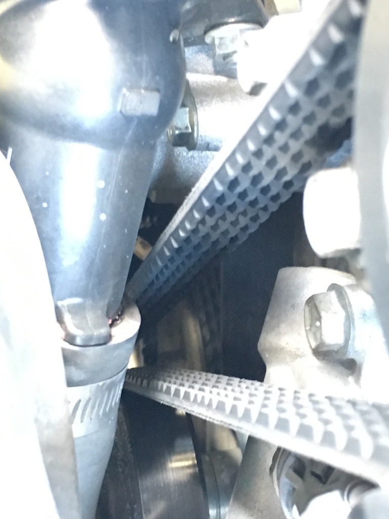

You can see a little crust where the hose meets the outlet:
I guess I was smart enough to leave the clamp pointed in a direction that can be accessed:

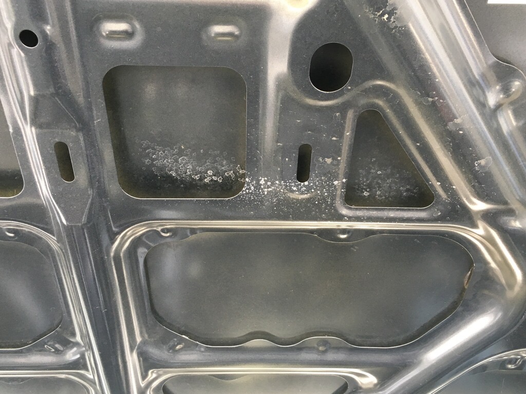

It drips on the belt and gets thrown onto the hood:
