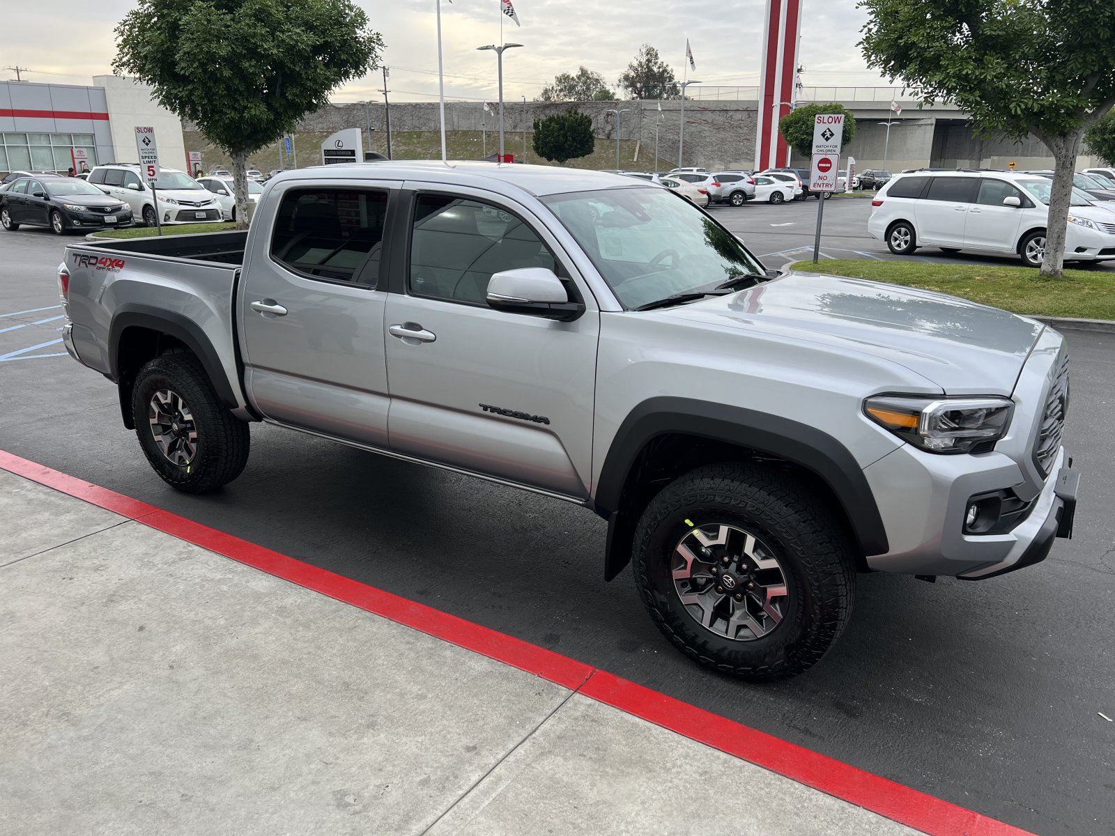

Hey All,
First time Tacoma owner here- just bought the 2022 TRD Off Road. Been loving almost everything about it with the exception of one thing. When talking to somebody on the phone using apple carplay or Bluetooth, the person on the other end hears a loud buzzing noise in the background. it is best described as a sound similar to a loud A/C unit or somebody running a lawn mower.
Has anybody ever had this problem? I originally assumed it was my phone cause it was kinda old so i bought a new one and it still makes the noise!
Any advice is appreciated. Taking it into toyota next week to look at.
