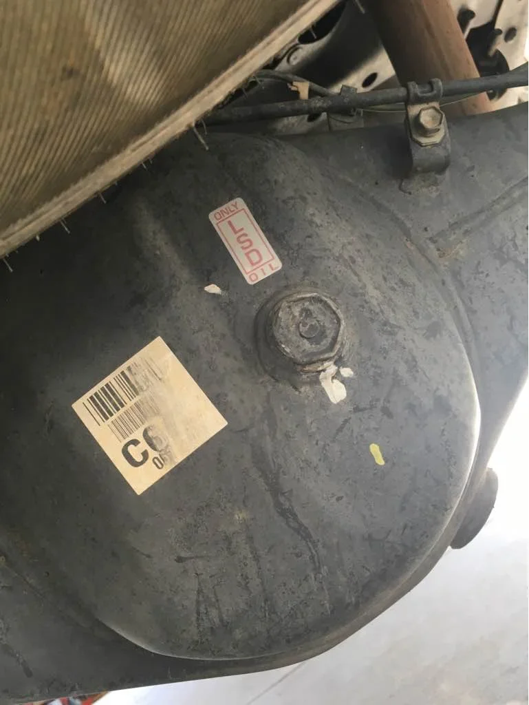

My 08 Trd sport double cab Tacoma has a LSD but no switch in the cab to activate or deactivate it? I know it defiantly has a limited slip because of the sticker on the rear diff. I think it's an auto LSD but I'm not too sure how that works. Can someone please explain this to me?
Only the off road models have the switch for an electronic locking rear diff.. The sport models like you have with the limited slip work completely different than the locker...

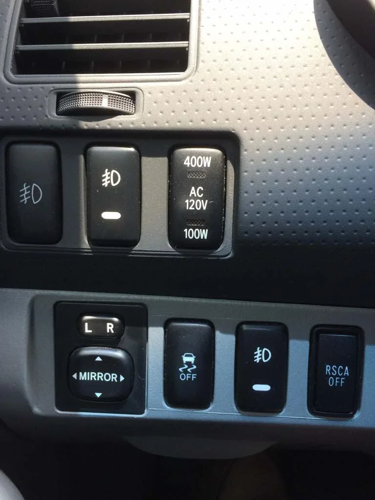

This is on my 13 sport, not sure if it's the same for you...
Push the bottom left button once

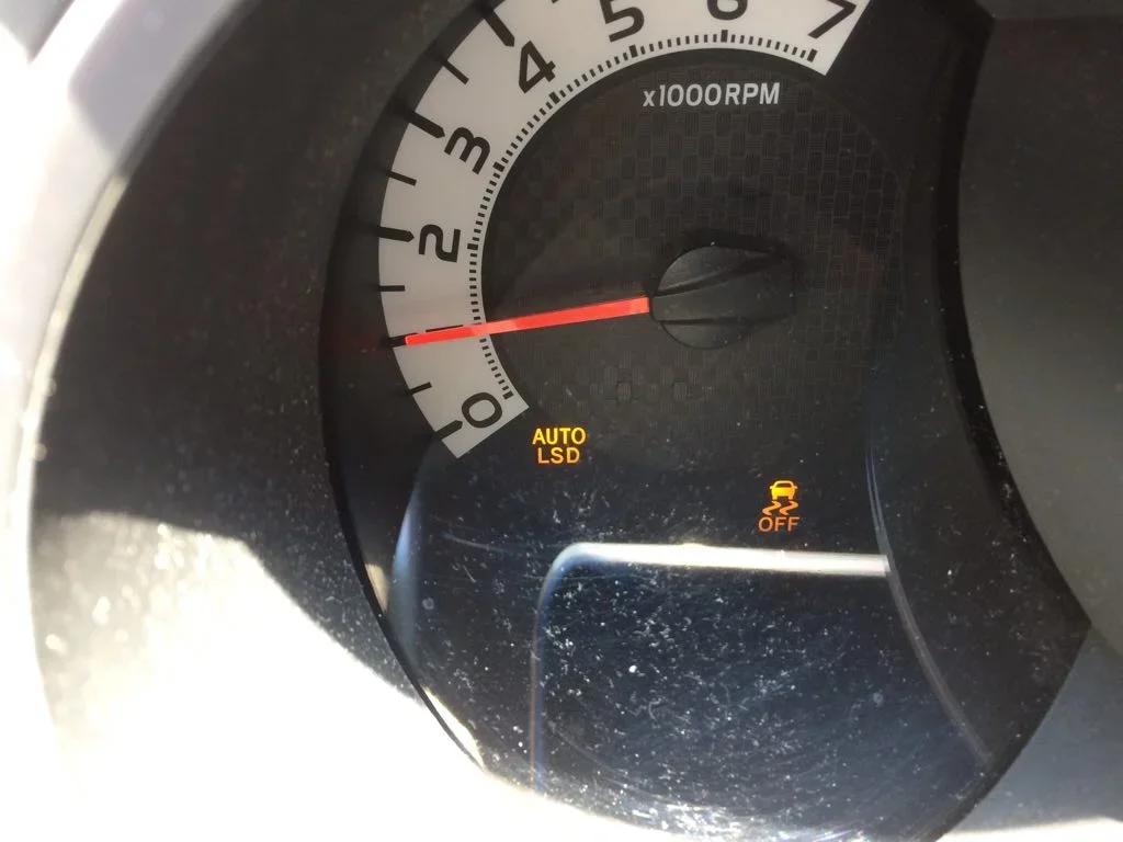

This comes on in the dash

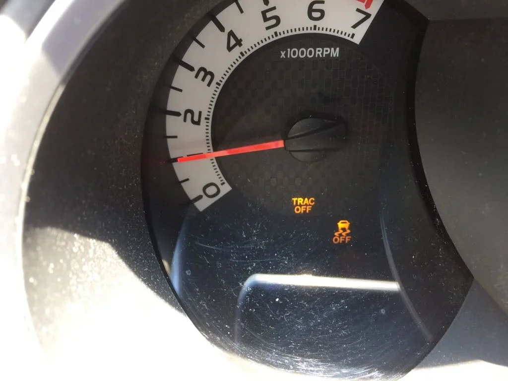

If you push and hold the same button for 4-5 seconds, this comes on it the dash, doing this turns everything off, including the auto LSD

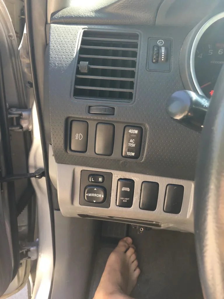

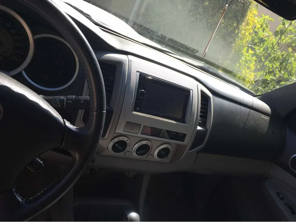

I literally do not have a traction control switch. There's nothing there, but my diff is defiantly limited slip.

See guys there's no switch to turn on the LSD. But yet I still have a LSD on my rear diff? Again this is an 08 TRD sport Tacoma.

You have an actual limited slip differential. There are mechanical clutches inside that lock, or nearly so, the differential action when you have wheel spin. The clutches work automatically and there is no electrical component to them to turn on and off.
