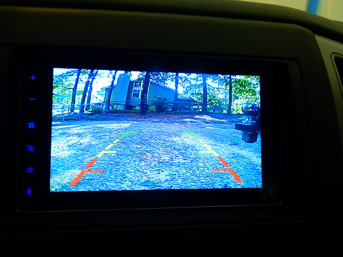

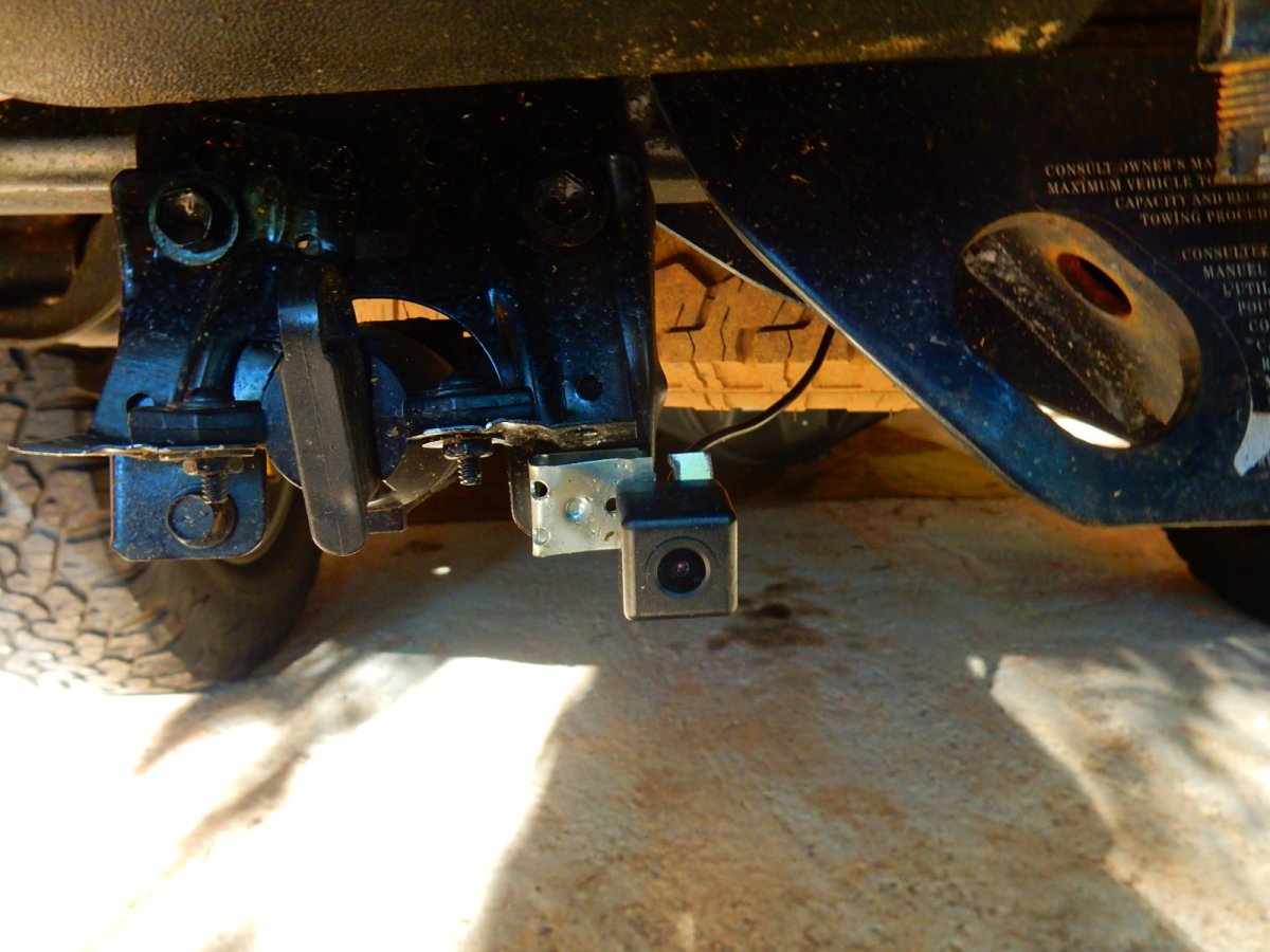

Whew got mine going about a week ago. It didn't work when I got the truck 4 months ago. Mine is a 2010 w/ pioneer double din. my rear view picture showed a blue screen for about a sec then went blank while in reverse. I got a new cam from walmart for $15. wired it to the taillight reverse wire then along the frame. wire comes out under front seat area. I couldn't get a good angle on it while mounted by the tailgate handle so I mounted the cam by the trailer hitch receiver area.
