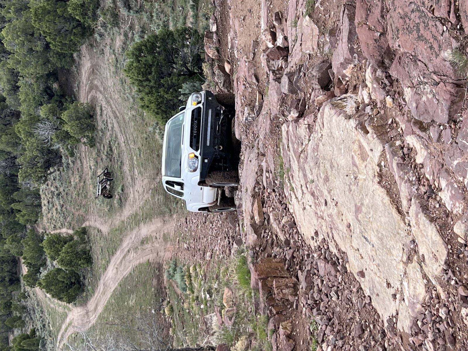

I purchased a low mileage 2015 TRD Pro last year and installed a front bumper with skid protection and very improved approach angle with a winch. I also installed a higher clearance rear bumper and substantial rock sliders. I took it on its first serious off road trip over Memorial Day. It is a very low mileage truck that still has the original 265-70-16 BFG All Terrain TAs. While all the factory toys are pretty marvelous (Atrac, locking rear diff, DAC), two things from the first trip are apparent:
First, more ground clearance would be nice. I love the existing factory suspension, so I don’t want to lift it any more than it is. What is the biggest tire I can put on the truck with the stock suspension and the 16 inch TRD Pro wheels with out screwing up the highway handling or rubbing on stuff I don’t want to rub on.
Second, a locking front differential is pretty necessary for the trails we want to cover. Has anyone tried the Eaton Elocker? It is the only electric front diff locker I have found. Is it hard to install? Does it function correctly? Are there any downsides?
