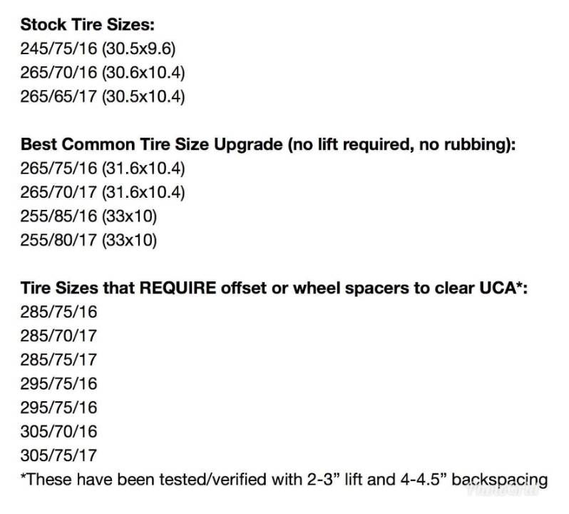

I’ve read guys putting 285/75/16 on but they did a CMC and wheel well mod to make it work and even then when stuffed your going to have some rubbing.
If you can find 275/75/16 or 275/70/16 will work.

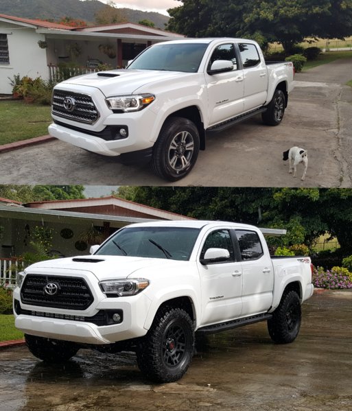

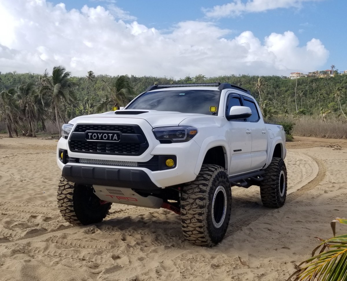

I used to run 285/70 with stock suspension , only the mudflaps had to be removed and little trim of plastic fender, the i switch to 33x12.50 with a 3 inch lift kit and at the moment is sitting with a 8 inches of lift and running 37x12.50 tires on 17x9 et-38full.jpg thats with 285/70
There with the 3" inch lift and 33" tires, 2 inch wheel spacer
There with 8 inch lift and 37x12.50 tires, wheels 17x9 et-38
I used to run 285/70 with stock suspension , only the mudflaps had to be removed and little trim of plastic fender, the i switch to 33x12.50 with a 3 inch lift kit and at the moment is sitting with a 8 inches of lift and running 37x12.50 tires on 17x9 et-38View attachment 17542 thats with 285/70
Great lookin' truck! Welcome to the forum!
What did you use to get 8”?
