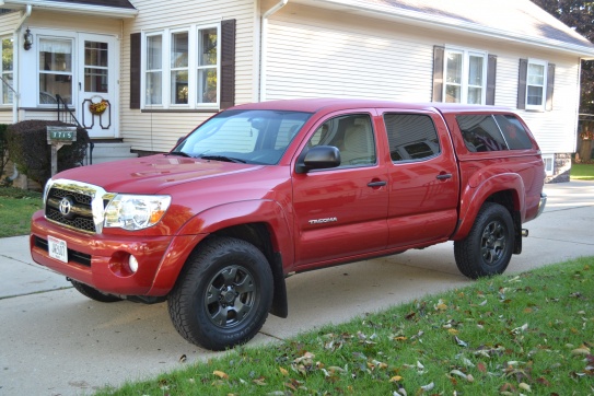

Bought the truck back in February of this year with 38k...now have 50k. This is my first Tacoma, and I have a clear vision of what her to be. I have done a few mods, but have many more to come. Here's a start.
2011 Tacoma 4x4 SR5 Double Cab
photo.php
Day after I brought it home
photo.php

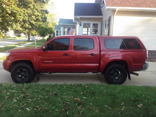

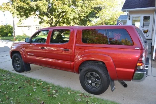

Borla Pro XS muffler installed at muffler shop with custom bent dual pipes.
18 in rolled stainless steel tips
Muffler and TacomaForum merch arrive the same day
picture.php
picture.php
picture.php

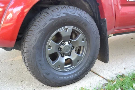

Ditched the Dunlops and got Cooper AT3's. All around great tire, but did have a lot of problems balancing, they are a heavy tire.
265/75/16
picture.php
picture.php
Wanted to get the rims sooner but didnt have the cash to shell out for any other mods, so I went a cheaper route. This should hold me over until I get the Micky Thompsons.
Plasti-dip Anthracite Grey. Covered extremely well, I was impressed with the results, and added a coat of glossifier for a little shine.

Here's a step by step. I wish i took pics of the process, but there are a lot of how to vids on youtube of the same thing.
I painted the rims while still on the truck. Surely taken them off would serve as a much easier way to paint, but I didn't have the time.
Step 1
-Hosed my rims with a ammonia based solution, DYC gave me a pre-dip spray with the kit, but you can just use any wheel cleaner or even windex.
-Deep clean with a rag and q-tips so I had absolutely no dust or dirt.
-Wait about an hour for the rims to dry.
Step2
-Mask rotors, calipers, and drums to prevent overspray. You can use small kitchen garbage bags for this, just cut the bottoms off and tear down the middle to make a long piece of plastic to feed in between the spokes of the rim.
-As you are feed the bag through the rim, spread out and push up and around the back of the rotor to assure full coverage.
-Make sure the bag isn't over lapping any of the spokes or parts of the rim that you want painted, and try to keep it from touching the rim. This will prevent tears in the paint after it is removed.
Step 3
-Take your choosen color and a shake the can just like any other can of spray paint, shake well.
-Apply one very thin coat to your rim. Keep it moving around the rim and make sure to get every angle possible to assure even coverage in the end. Keeping it light will prevent unwanted drips.
-Wait at least a half an hour between each coat for drying time, I waited about an hour, but that may have been overkill.
-Continue adding more coats, remembering to keep the spray at least 6 to 8in away from the rim to prevent build up and drips.
-You will want to have at least 4 coats, I would recommend 5 or 6 for durability.
-Let rims cure over night before driving at high speeds, if you cant wait that long, at least 4 hours of curing time is needed.

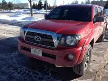

Installed the Anzo headlights. Love the look of the black housing and the light output is great. Wish I had a better pick...without the snow and salt, it's been a long winter.
