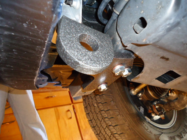

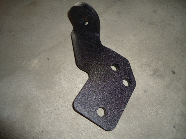

Here's a pic of the BP Fab recovery bracket. Very nicely made and powder-coated black.

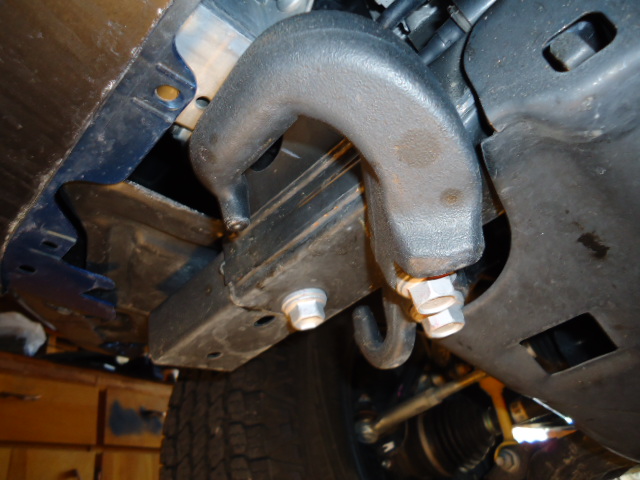

Removed the 2 bolts that hold the OEM part on including the lone bolt holding the end-cap on since the BP Fab is a 3-bolt attatchment. I used 3-M12X1.25"X40mm Grade 8.8 bolts for the install of the new BP Fab recovery hook. I torqued the 3 bolts with flat and lock washers down to 48 ft/lbs with some blue loctite on the threads. 48ft/lbs tightened them up pretty tight! Here it is installed........

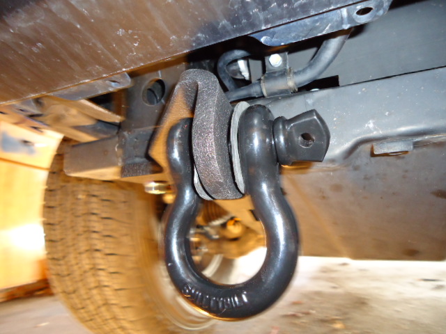

Then, I purchased a 4.5ton D-Ring to attatch that's 3/4" with 7/8" pin.......I had some old truck innertube laying in the garage so I cut off a couple pieces and placed them on the inside of the D-ring on each side so any noise from the D-ring moving would hopefully be minimal.
Here's the final results..............A much stronger tow/recovery hook than OEM.
