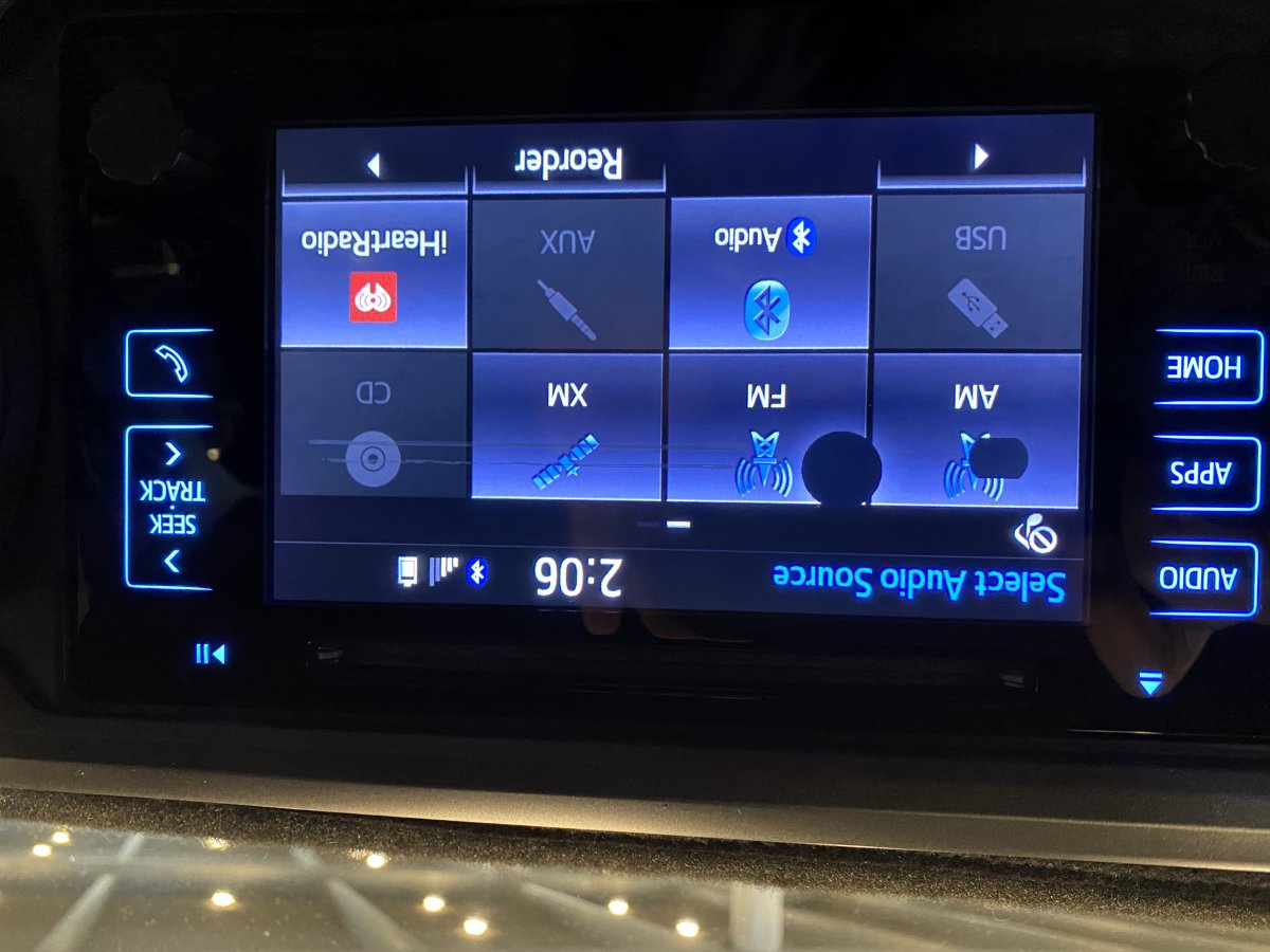

So I damaged the LCD on my 2016 Tacoma. I brought it into the dealer to get a price on a replacement. I was told that the technician didn't see any signs of impact or abuse to the unit so it should be covered under my extended warranty. The touch function still works and the radio works normally (aside from the dead spots on the screen). Well I got a call this morning that my radio was at the dealer BUUUUUUT it would not be covered under my extended warranty and would cost me $3176.58 to have the unit replaced. Any suggestions????

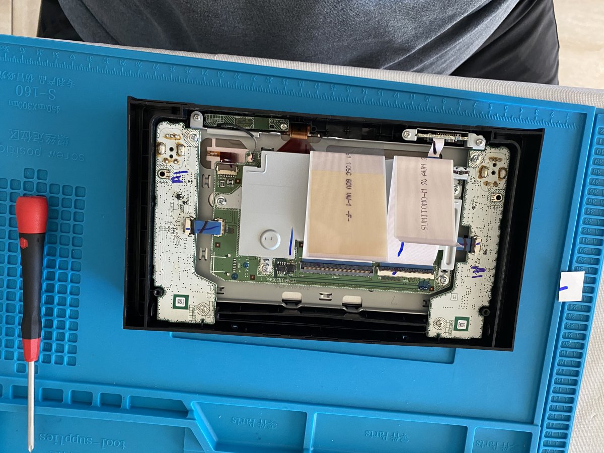

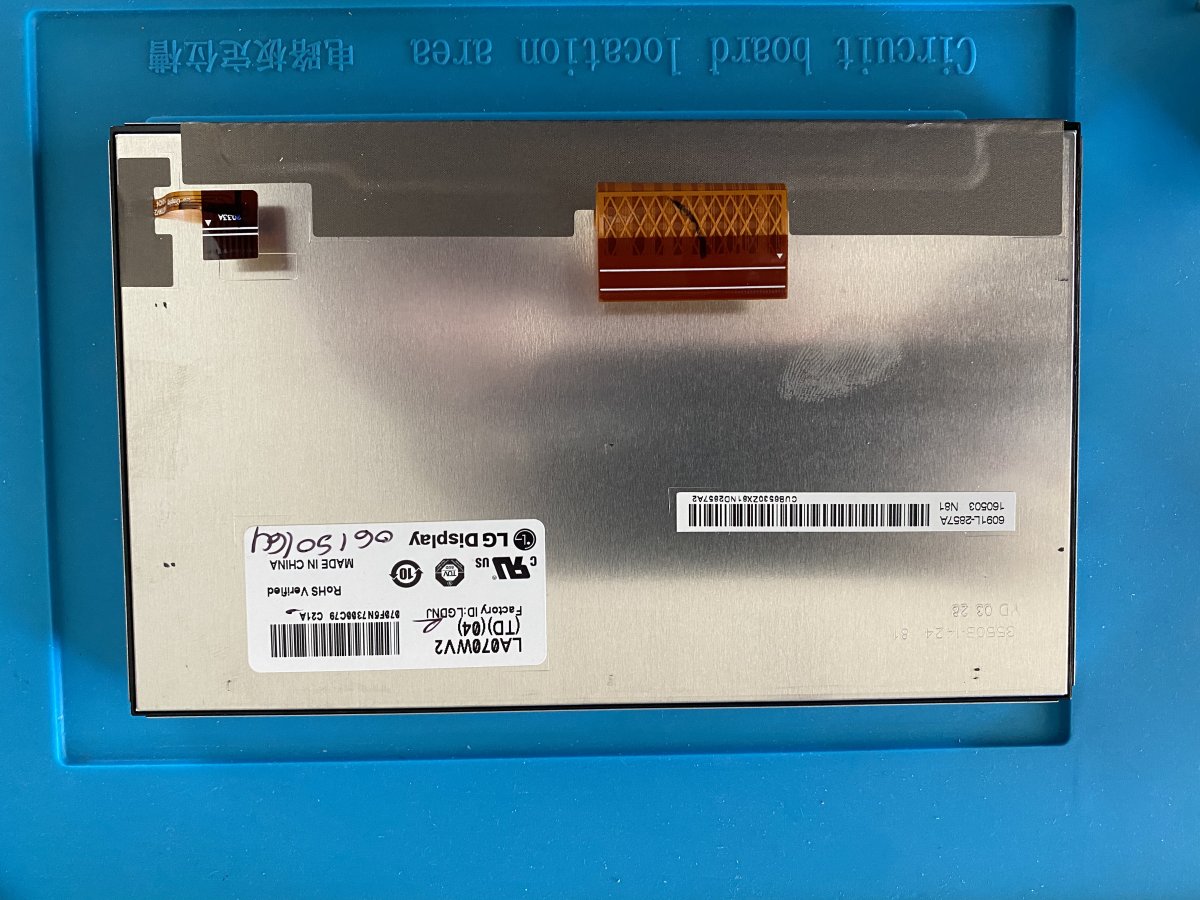

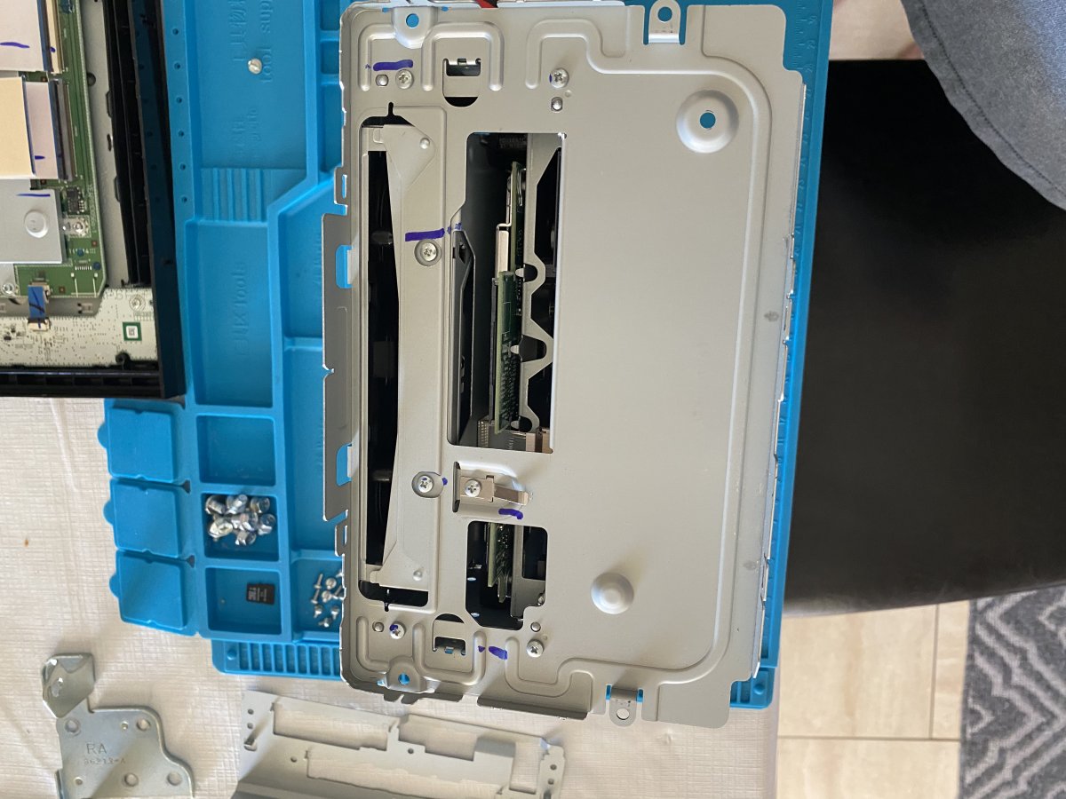

After extensive searching I found a source for a Toyota premium 7" radio LCD. The radio is manufactured by Panasonic and the display LCD is manufactured by LG. They do not stock the LCD in America so I had to have it sent from China. A little over two weeks and I am now the proud owner of a new LCD. Now to install it IMG_1205.jpeg image.jpeg IMG_1204.jpeg IMG_1205.jpeg

After extensive searching I found a source for a Toyota premium 7" radio LCD. The radio is manufactured by Panasonic and the display LCD is manufactured by LG. They do not stock the LCD in America so I had to have it sent from China. A little over two weeks and I am now the proud owner of a new LCD. Now to install it View attachment 32614 View attachment 32615 View attachment 32616 View attachment 32614
How much was just the screen. Because I have a JBL Premium Headunit out of a 2019 I'd dump. Lol.
I paid $67.58 for the display and $77 shipping. I got the screen pretty quickly and it functions exactly as the original. The seller said that he had seen this issue before with the LG screens. I reached out to LG and they acknowledged this as being a rare issue. Since I already paid for and installed the LCD, LG offered to reimburse the price of the screen replacement or compensate me with another LG product to choose from. I took option 2 and LG took care of the rest. It's nice to know that there are some companies that still offer good customer service.
