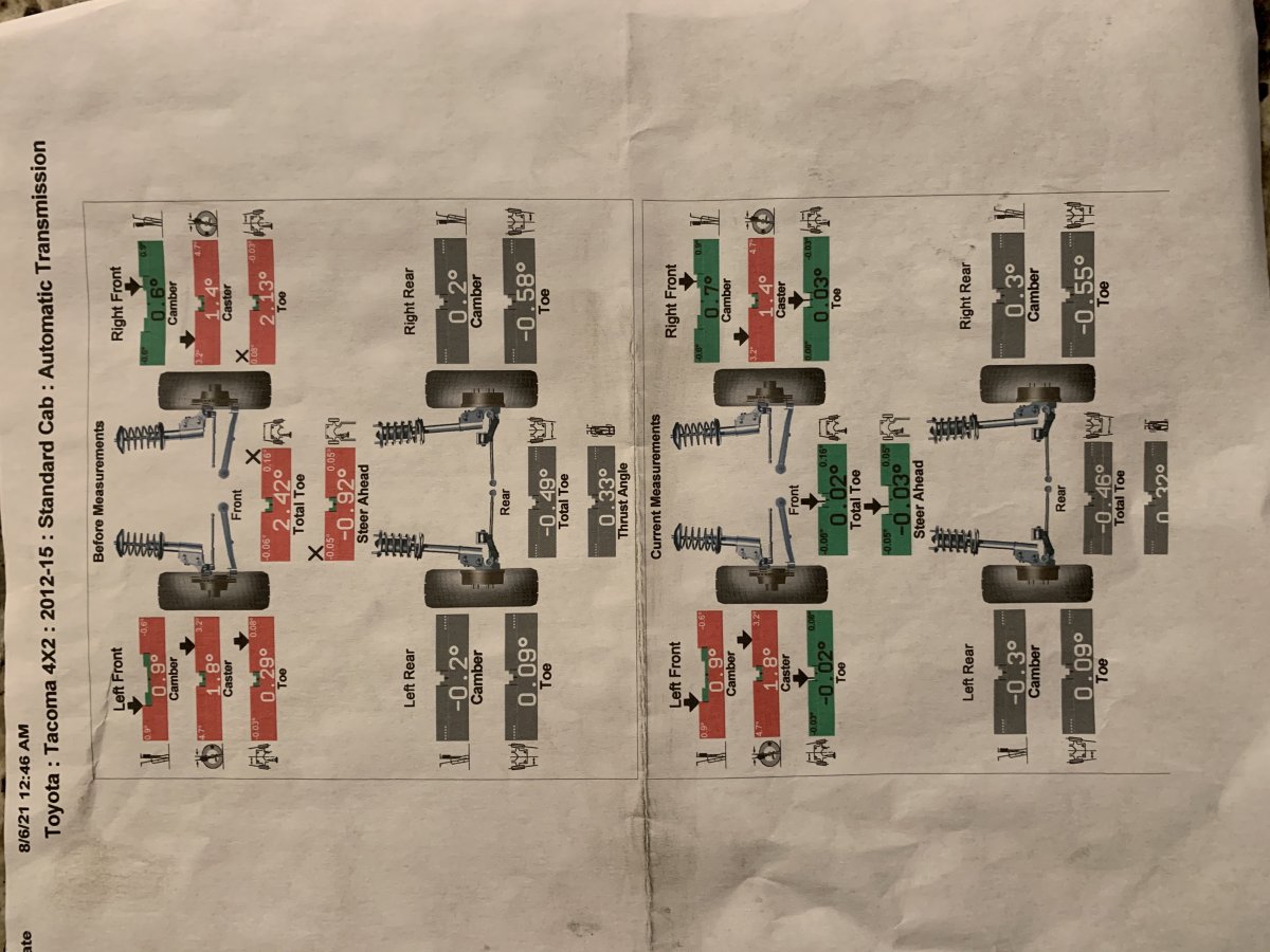

Hey. I have a 2016 Tacoma SR 2wd with a 3” leveling kit and everything else stock. I have taken the truck to get aligned 3 different times and can’t get the camber correct. Any tips?
Most of the time with a 3” lift you want the caster close to 3* that usually allows for the camber and toe to be close to 0.
It really doesn’t look to far off for having a 3” lift without new UCA.
How does it handle while drive?
Maybe look into a spindle lift since you’re a 2wd.
Most Tacoma 2-2.5 lifts a aftermarket UCA , May not be needed. But does help.
For yours I suggest looking in the SPC upper control arms $700.00 and under.
Finding a shop that knows how to install and dial the SPC upper control arms you may need to do your homework.
Our local tire shop sells the SPC upper control arms, installs and do alignments. Plus lifts.
Good luck
