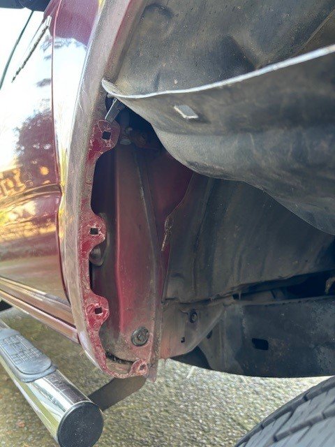

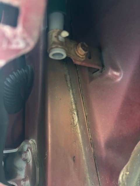

This looks like it might be the drain inside the fender. if it is, compressed air won't go through it so it's either severely clogged up or it has a one way valve on it. Looks like I'll have to take off fender to get at it on bottom of cowl.
wow! that is interesting that there is a rubber drain hose behind there
i was not aware of that being there, never had the liners off that far or anything like that

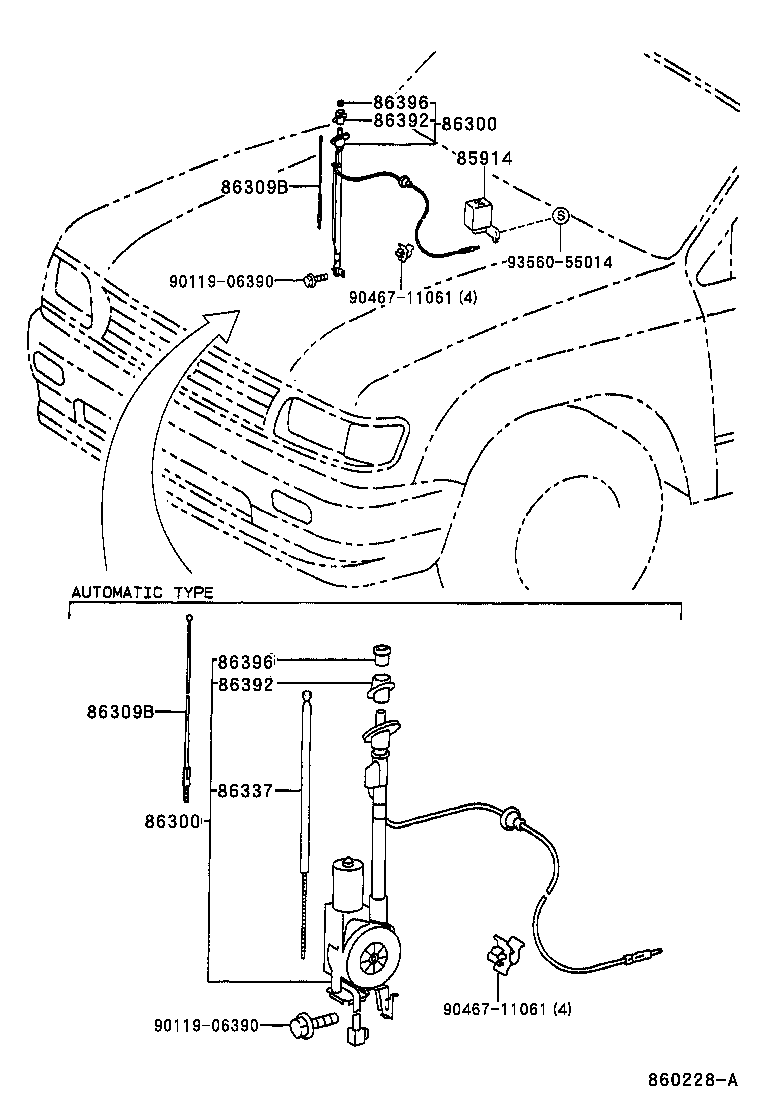

looking at a parts diagram
i bet that is the antenna bottom? and not a drain

You're probably right. There's a skinny black wire or tube that goes alongside the plastic tube. So, i'm still stumped and no one seems to know what the answer to the question is. Where's the damn drain hose for the passenger side of the cowl?
