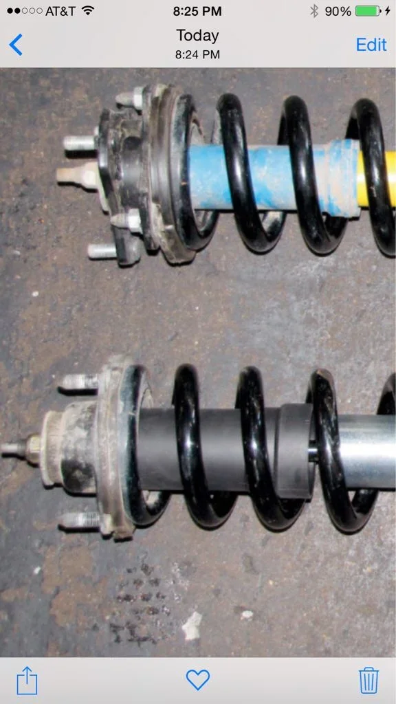

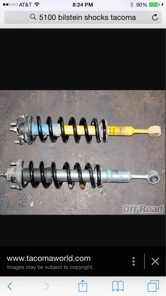

First one is the difference between TRD Bilstein upgraded yellow strut and what I use Bilstein 5100's big diameter difference!!ImageUploadedByTaco Forum1422322479.046190.jpg

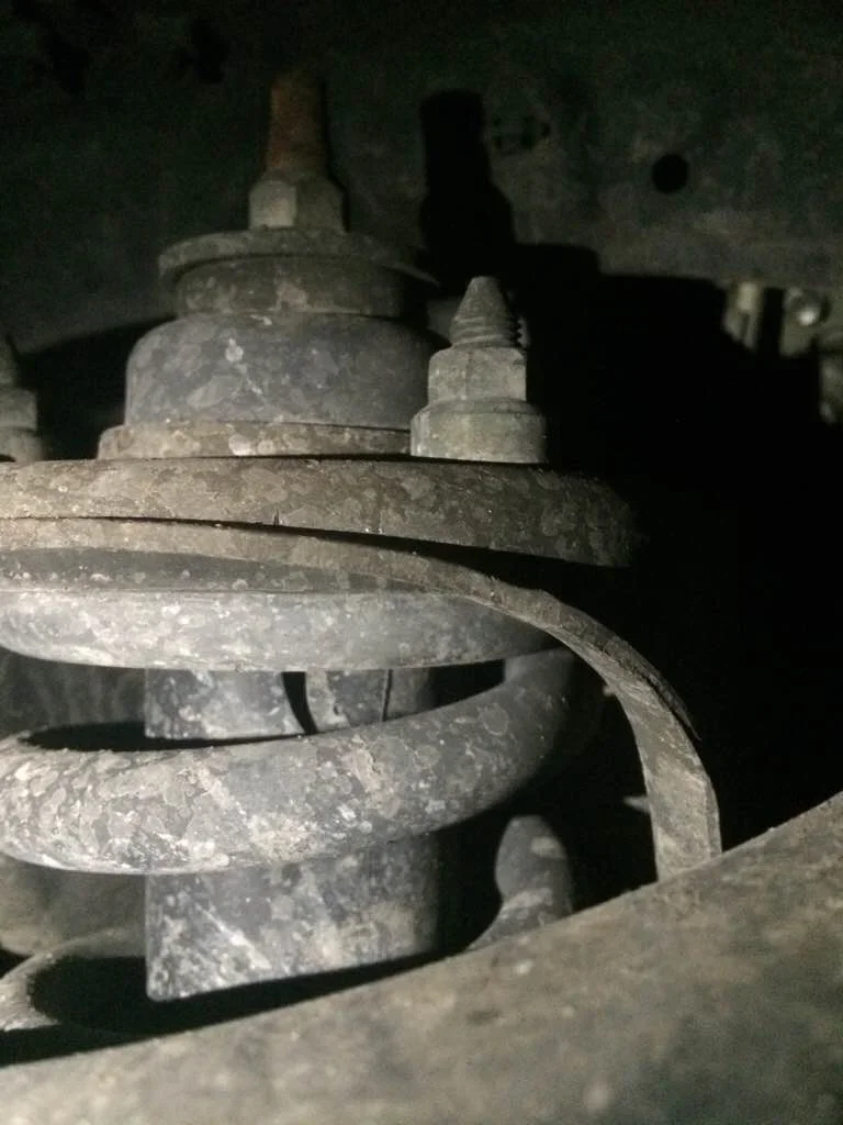

This one is a zoom of the strut top with plastic piston cover! Yours has a crack no big deal. If the strut is not bent and looks structurally sound!
