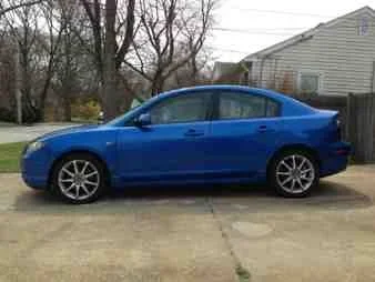

Looked good on my old mazda 3, took the door trim off too looked super clean. ImageUploadedByTaco Forum1368228377.284351.jpg
Final snap i took before i traded it for the tacoma.

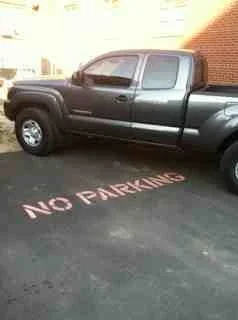

I like the look. I took all mine off. I later added a black TRD to the tailgate though.
When I first did it years ago...
