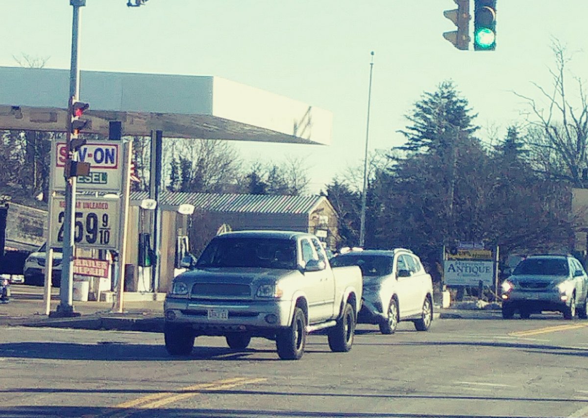

20210217_082805_Film1~2.jpg My '03 tundra v8 had 135 k on it .I never changed it. I see it 2 times a week still driving around the guy still waves to me so he must still be loving it lmao. It's a great truck .
