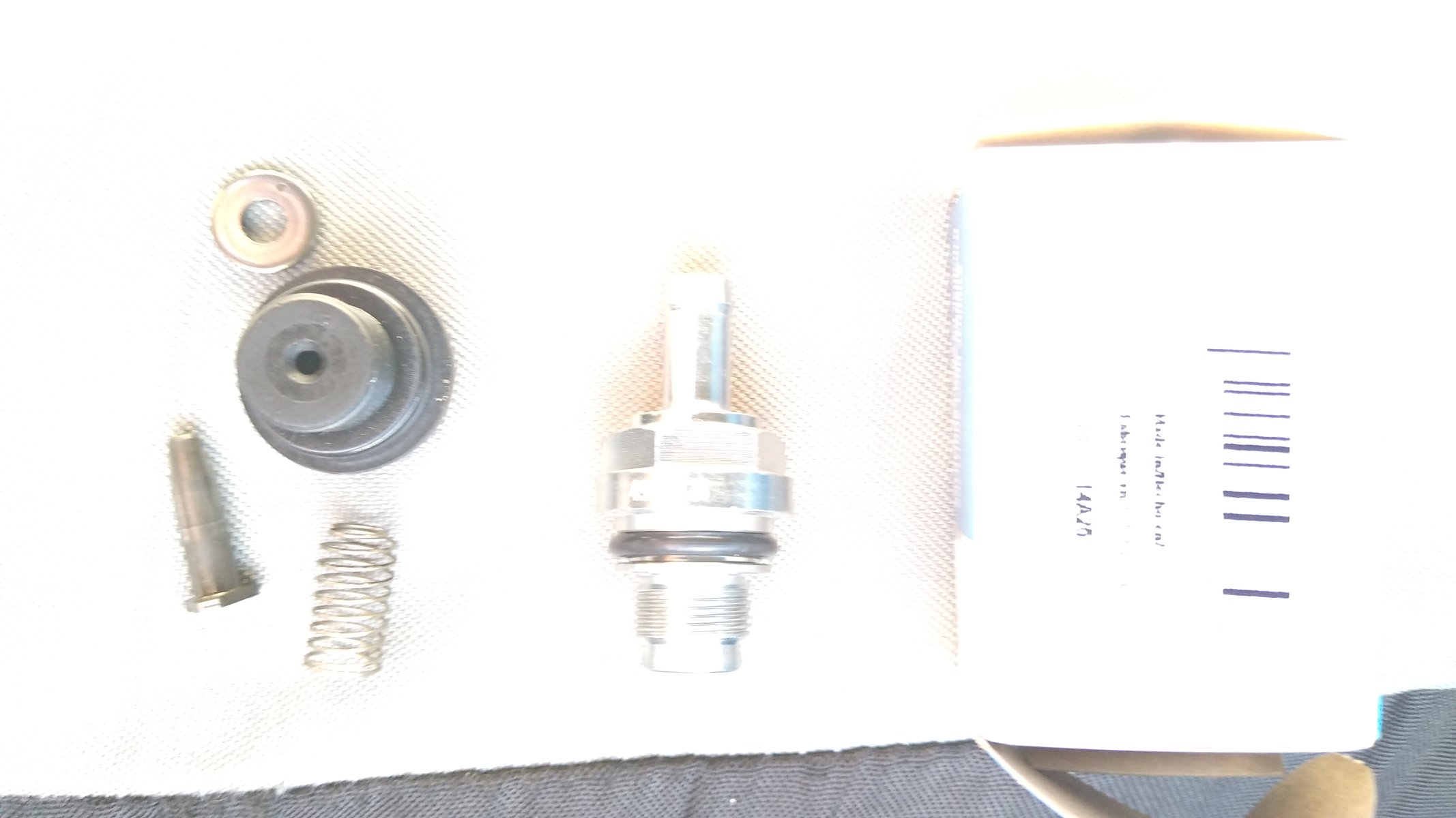

heres a picture of the old broken OEM pcv next to the new metal AAP carquest version
