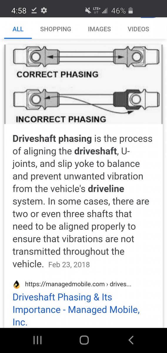

Also did you put the driveshaft back in it, in phase?
