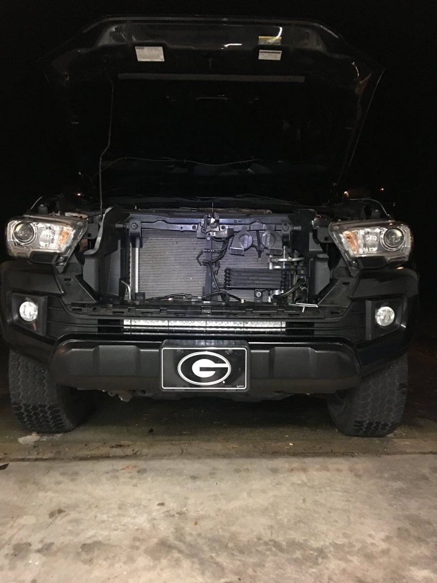

I’ve had a few questions since I posted on another topic here about the way I mounted my light bar. I had some time tinkering in the garage and figured I’d take my grille off and get some better photos.

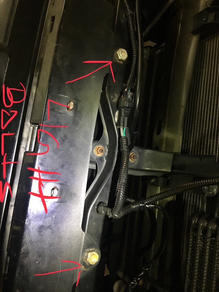

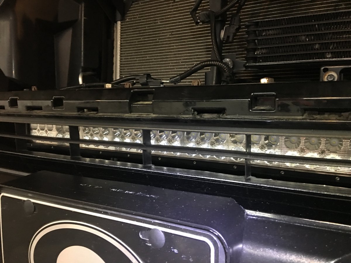

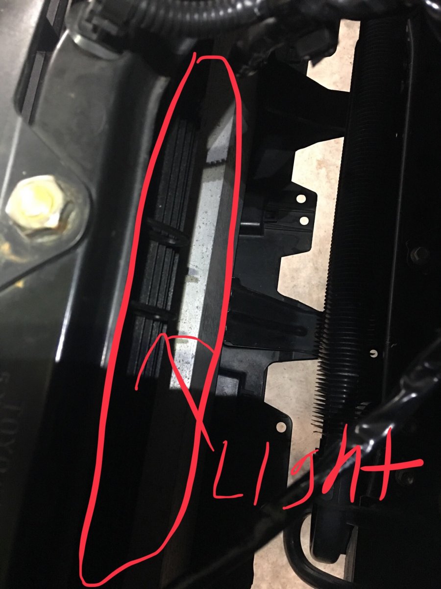

The 2 bolts shown replace the plastic clips that were originally there and they are attached to the light bar bracket which allows for tilt up and down to get it where you want it. It is a tight fit to get it where you want it and tighten it down, but works great and for $38! Hope this helps the ones with questions.
