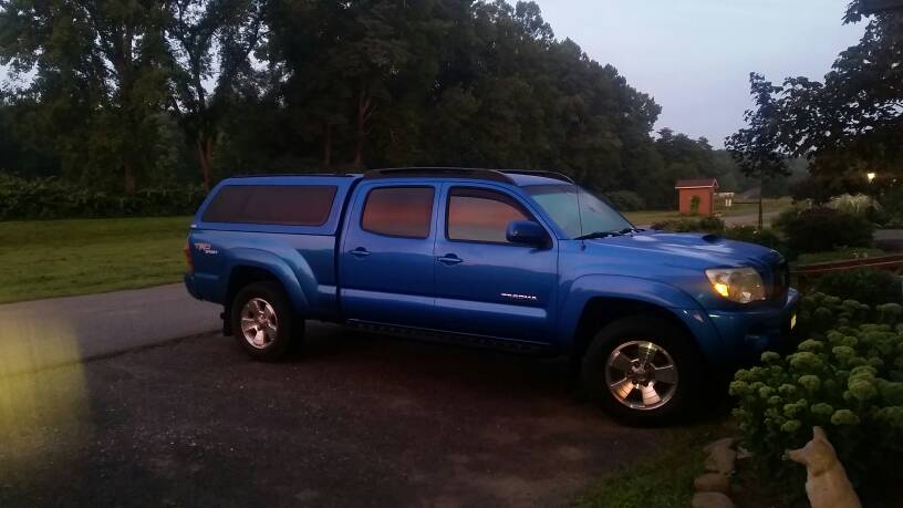

This is my first toyota. 2008 tacoma anything I should keep an eye on ? Has 77k miles. Traded in my 2008 gmc 3500 hd with 170 k on it Tha ks for any info on it. View attachment 20283
Congrats on the new to you Tacoma. Welcome to the forum.This is my first toyota. 2008 tacoma anything I should keep an eye on ? Has 77k miles. Traded in my 2008 gmc 3500 hd with 170 k on it Tha ks for any info on it. View attachment 20283
