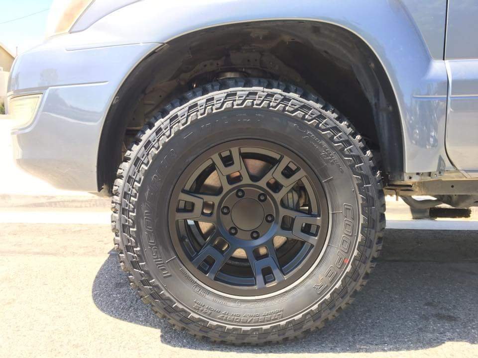

What one do you like better and what size tire are you planning on running?I have a 2016 TRD Sport, I don't go off road. Recomendation on this two and if is better to lift. View attachment 15930
FN Wheel is 17x8 and the Sema pro is 17x7. You think that extra inch makes any difference. Want to keep it simple but don't mine to lift or at least level back and front. Sorry if I said something weird don't know much about the topic.What one do you like better and what size tire are you planning on running?
Your stock sport rim is 17x7.5” +30 offset.FN Wheel is 17x8 and the Sema pro is 17x7. You think that extra inch makes any difference. Want to keep it simple but don't mine to lift or at least level back and front. Sorry if I said something weird don't know much about the topic.
265/70/17 at stock height. You could go 275/70/17 with those wheels and a 1.75” lift. If you add bilstein 5100’s set to 1.75”265/70/17 or 265/75/17 maybe I can go bigger?
The FX pro 0 off set, TRD Pro 4
THX man. So the width doesn't make any difference on the tires265/70/17 at stock height. You could go 275/70/17 with those wheels and a 1.75” lift. If you add bilstein 5100’s set to 1.75”
The width of the rims or width on the tires? It does make a difference but you’ve got a good offset at 0 and it will be ok.THX man. So the width doesn't make any difference on the tires
That is with the 0 offset what about with the one that is 4 offsetThe width of the rims or width on the tires? It does make a difference but you’ve got a good offset at 0 and it will be ok.
Yeah it will be ok with +4. You will have some rubbing if you eventually lift it 2.5-3” and put 285/70/17 on.That is with the 0 offset what about with the one that is 4 offset
Thanks againYeah it will be ok with +4. You will have some rubbing if you eventually lift it 2.5-3” and put 285/70/17 on.
That would work.@OR17TRD or anyone what about this
