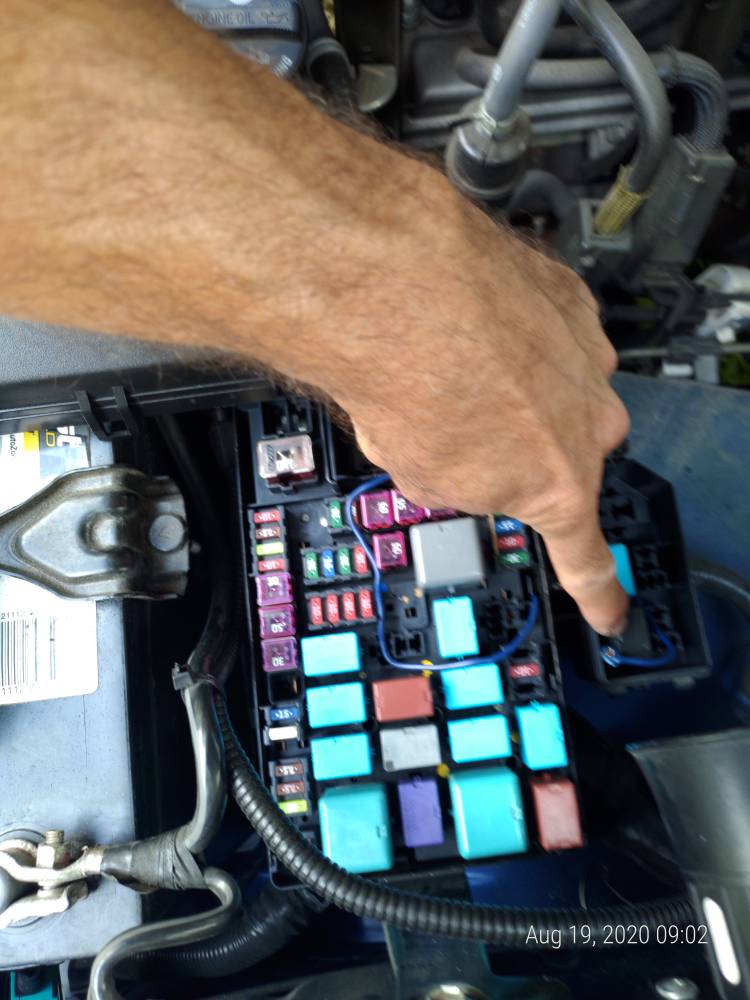

Take a relay out of an existing spot in the fuse box and try that if it works good to go. new relay.ok....so this is where t stands. I received my OEM switch and installed it.....no problem. Turned on power and lights and nothing. Viewed video once more on You Tube and purchased a 12 volt relay (4 pin) and installed (according to the parts store this was the relay for the fog lights on my truck)....no damn luck. So I am back to the beginning. I am questioning whether the relay I purchased is the proper one, as it would appear via the fuse box that the relay should be a 5-pin relay! Any suggestions welcome. My "Plan B" is to check all the connections-from the bumperto dash.....again, suggestions are very welcome.
Would you happen to know where the really for the 2015 Tacoma is? I can't seem to find the location on the truck. Thank you!They are easy. If you run into problems just ask and post pics of the trouble areas you have
