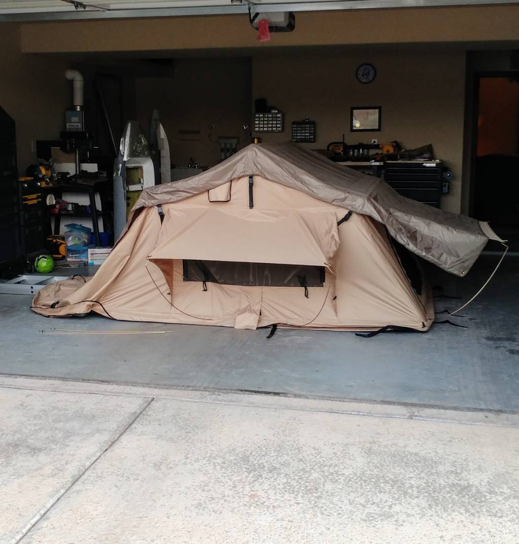

Looking for enough lift to fit 33s without rub. Front coilovers come with 2.5 in preload and the rear has an AAL (heavy duty) to support this monster RTT/bed rack/gear/[emoji481], you know the essentials. Issues? Advice? Cautions?Message_1518913768758.jpg
