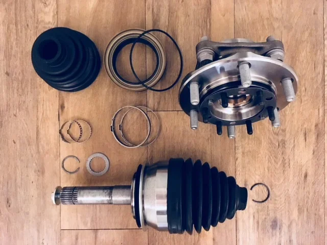

Replaces the outside joint on your OEM Toyota CV axles.
This mod will allow you to disconnect your CV axles from the wheels, sparing the boots and grease from unnecessary wear.
Alleviates parasitic front end drag, resulting in better MPG.
ABS/Speed sensor unaffected.
Can also install on aftermarket LT shafts, such as:
All-Pro Offroad +2" or Total Chaos +3.5".
Contents:
You will receive two boxes, each with everything needed to convert one CV.
Picture above is contents of each box.
OEM parts.
I opted to not include free wheel hubs in the price so you choose how to source those.
There are deals to be had on eBay or maybe folks already have some laying around from a 1st Gen.
If you buy new I suggest these:
Aisin FHT-019
PM me for order
No shipping fee within USA
Trail Spare- $285
Includes joint, boot with clamps, wire clip and grease.
Note:
Requires a 106mm+ wheel center bore.
