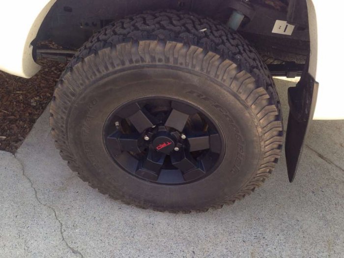

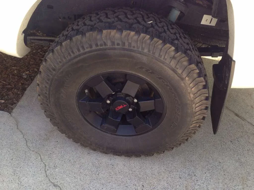

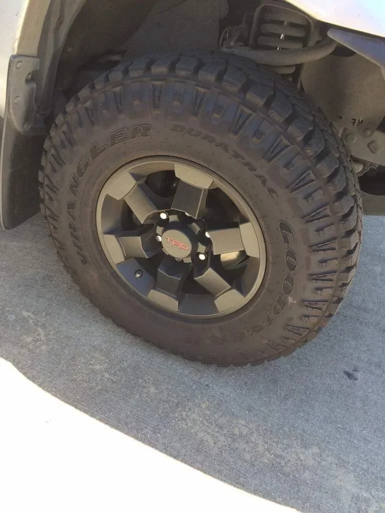

I'm on a aftermarket rim, well kind of, it's a rim from the fj's, and it's a 6 lug 16", I'll have to look at the tire size when I go back to my truck, I'll let you know
Thanks!! Mine are 235/85/16, don't think they have a 5 lug, if your asking what model mine is, it's a TRD sport...
Wheels
32's I think are the size of the tire, 3" lift too
265/85/16 was with a 3" pro comp lift, don't know if you can use 265/85/15's on a stock rim, they might be a little to wide....
