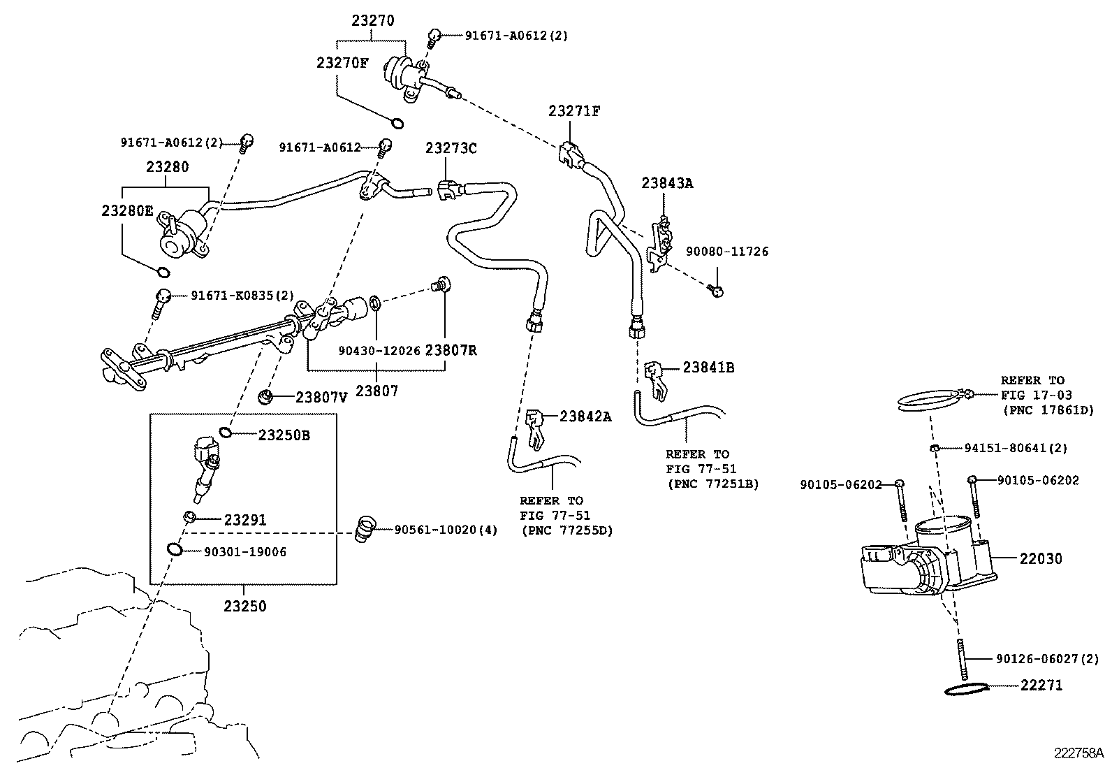

Get a pair of more powerful reading glass's ....23270 is your fuel filter.
'yes i already looked at the part
it is called the
Fuel Pressure Pulsation Damper Assy
here...
138 MSRP
but it does not say fuel FILTER like i thot it ought

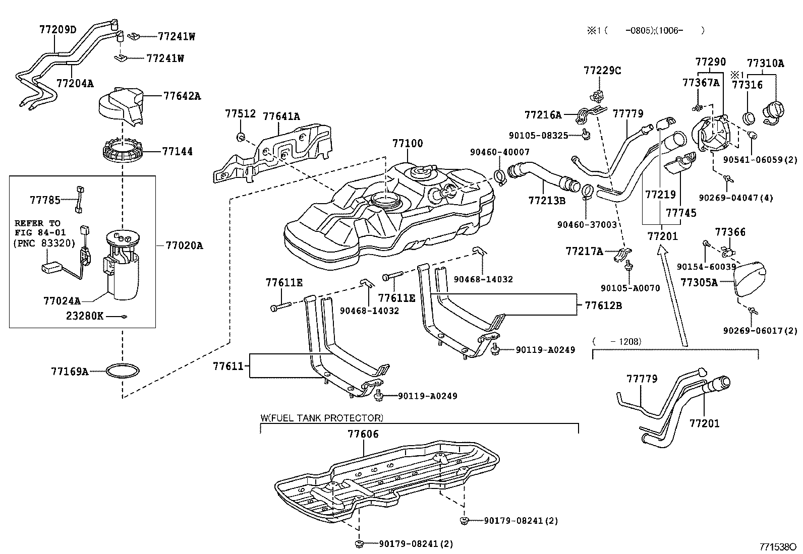

I just got done asking a friend about the fuel filter on these 2.7 tacoma's......you're right, it's in the tank...said toyota deleted the external ones around 2005 for their 2.7. Said to use only top tier fuel, and your likely to never have an issue.

Just flush out your tank, and see what crap comes out, if you need to know. Generally whenever you fill up at the gas pumps, the pumps have a very good filter already. Whatever small particles it might miss that get into your truck, get picked up by your trucks inline fuel filter before it goes into the fuel injectors.
