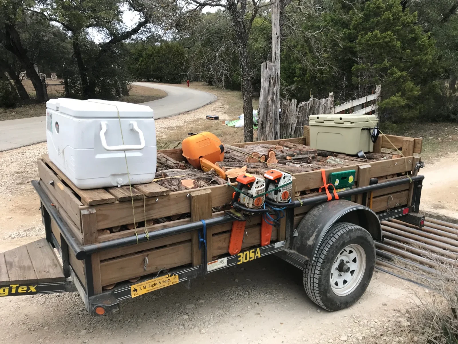

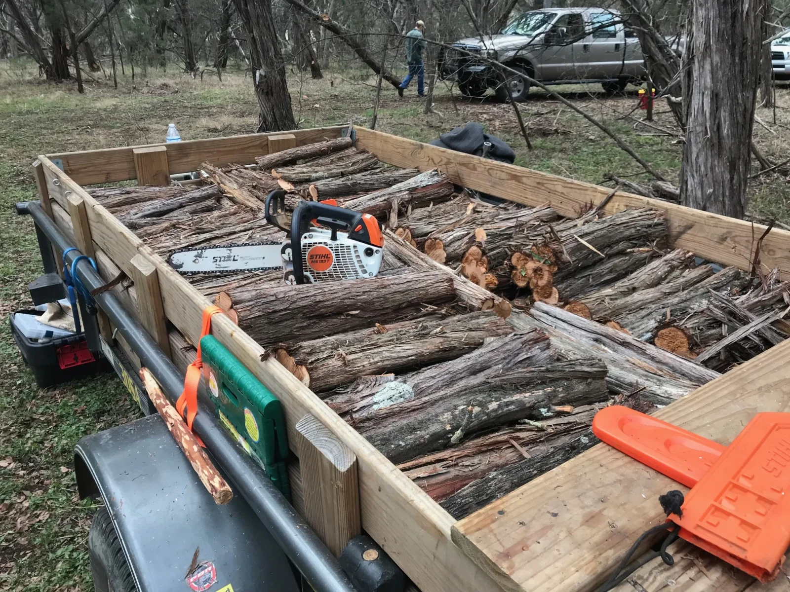

Hi. Out in the woods for the first time since getting rid of the big truck. I have a 5’x12’ trailer (see pic) that we load with dead cedar. The cedar is stacked 20” high & probably weighs 50-75% of what oak weighs. It will total out at 1,500 pounds plus the weight of the trailer itself.
I don’t know how much weight will be on the tongue.
My question is about tongue weight. This trailer has a heavy tongue already, made worse by the wood sides I added to it.
Worried more about completely depressing the Gen 2 leaf springs than the overall hauling weight
The bed of the truck will be loaded with normal gear, coolers, etc... nothing too heavy.
Guess I’ll know when I hook this thing up.

Weight distribution is also a question.
Watching this YouTube video would suggest that most of the weight has to be in front. With a 1,500lb. load and 1,500lb. trailer, loading with most of the weight in front will exceed my tongue capacity.
I can move some of the wood behind the axles but that will put more weight in the rest of the trailer.
I don’t want the trailer to fishtail from having too much weight in the rear, see video.

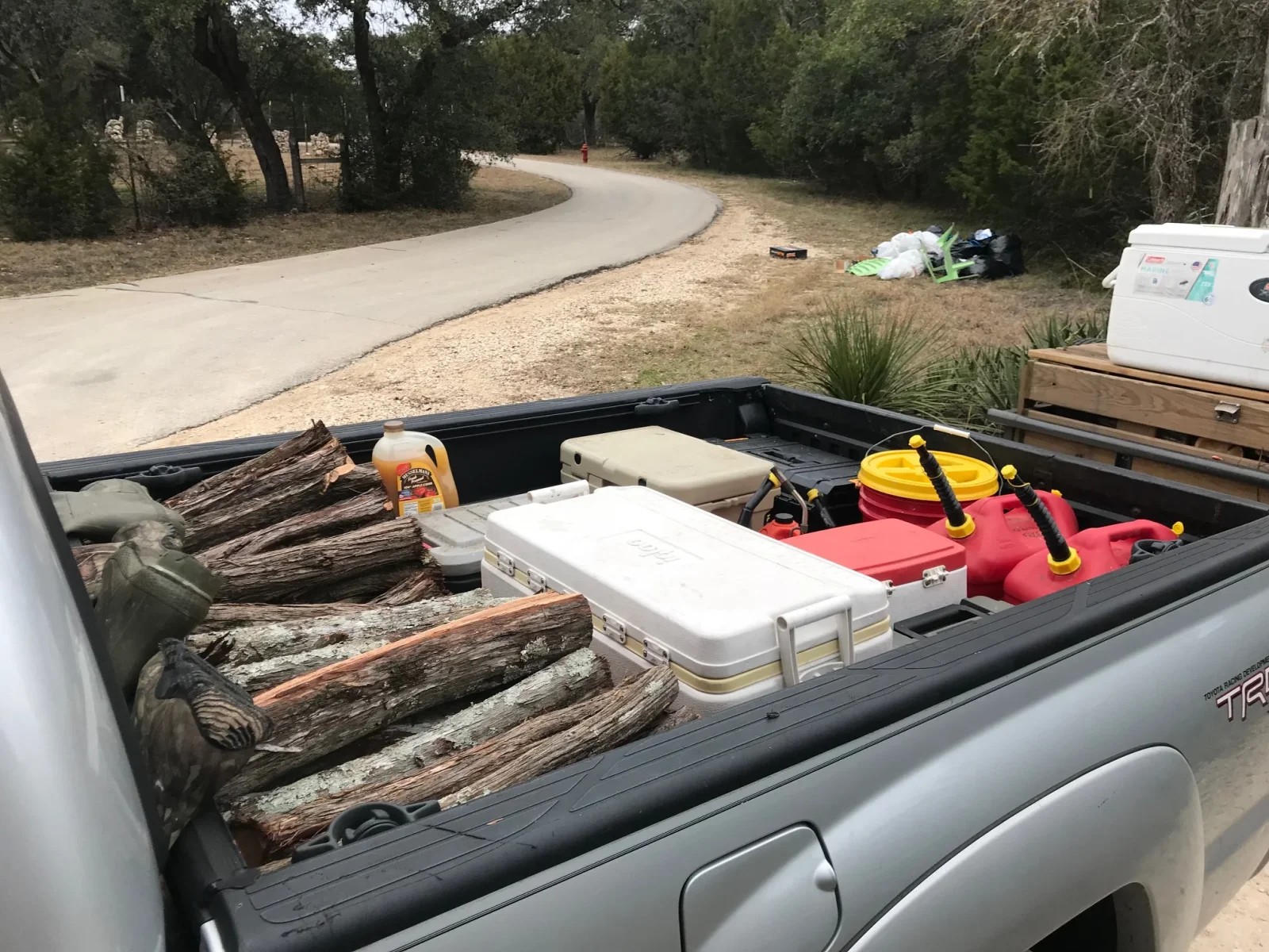

Well I made it back. Here was how I originally had it loaded. I changed the load around after a sketchy 20 Miles.
Pics below are the way I originally had it packed. I said, “the heck with the tongue weight & took wood out the back of trailer & put in Tacoma. This completely flattened the leaf springs but improved my sense of control tremendously.
