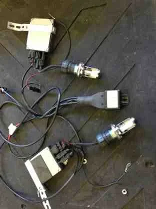

I picked up a p-n-p 35w 4600k kit from a reputable vendor and I just gotta say the light output is horrible! It has a great cut off and spread but its like I dimmed my stock halogens by at least half! Needless to say their coming out! Anyone need a set of bi xenon's pm me if your intrested....
I used to think PNP HID kits were cool but then I started seeing everyone with them. Mini vans, pos ricer cars, family sedans and trucks all had some not in them and usually one light was blown. I experienced first hand how much they suck in reflective housings. I got a set for my quad and they sure looked brighter but the scattered light was useless for riding at night. My friend had a set in his 07 F150 and the same thing happened. The scattered light output is useless for night use. Again these are PNP kits installed into reflective housings.
55w should give you a brighter light output, it did when I had 8000k HID's on my '05 Mustang, just info from my past HID problems, lol!
PNP HID kits do suck without a retro, however, if your saying they have a "perfect cutoff" then you may have done something wrong. Its not possible to put an HID bulb in a stock housing and get a cutoff. So something makes me think there is a different problem here. And dimmer than halogen.... Not a chance on the planet. No matter how ****ty they will still be brighter than halogen. Are you sure these are HIDs with ballasts and everything?
