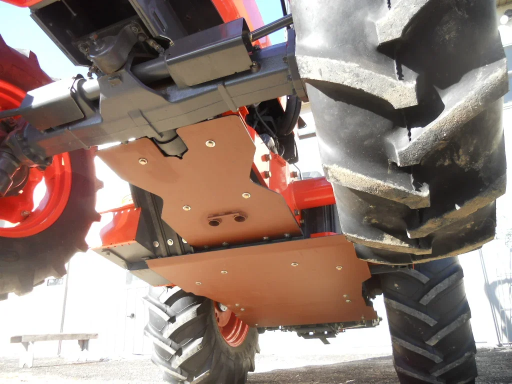

1/4" imo would be too heavy and unnecessary. I used 1/4" on my 6 ton tractor for a skid plate and it will easily support the tractor on a stump or big rock. 3/16"should be fine and if your buddy has access to a metal break he could possibly bend in some stiffeners and use 1/8". It all depends on how it's supported and the design, along with your realistic expected use. (rock crawling vs. weekend trail run) A skid plate bending while protecting a component is a reasonable compromise if your truck is your daily driver.DSCN1807.jpg
