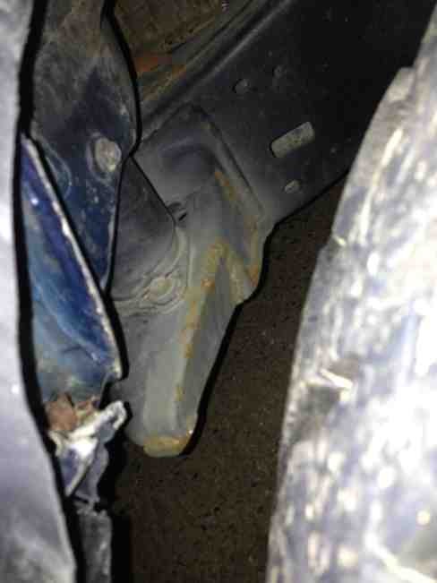

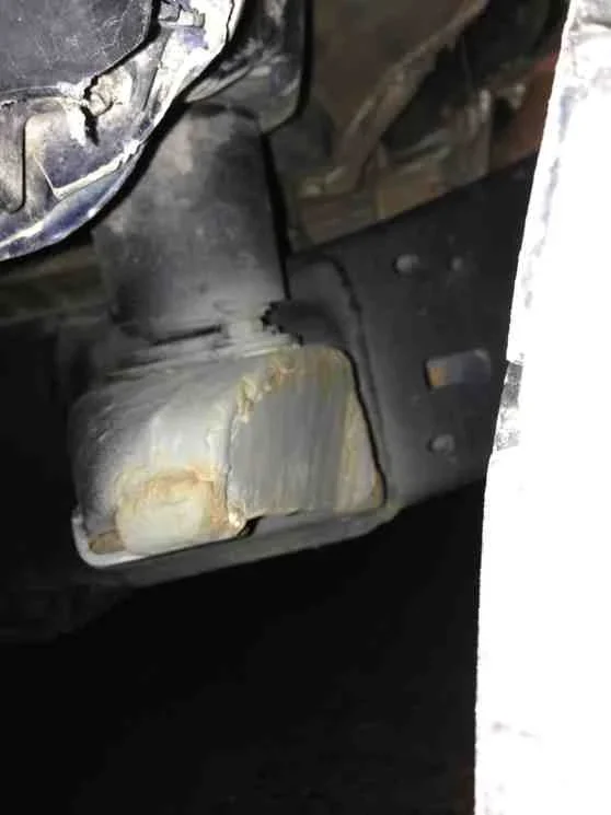

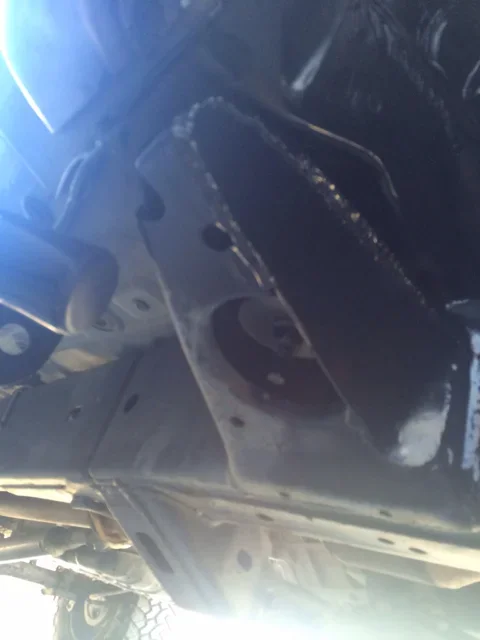

I have billy 5100s up front (2.5in of lift) and a 3inch body lift and I had to cut the cab mounts to fit 35s. And I have 1.25inch wheel spacers ImageUploadedByTaco Forum1392774699.289172.jpgImageUploadedByTaco Forum1392774707.738956.jpg and I still have to under coat

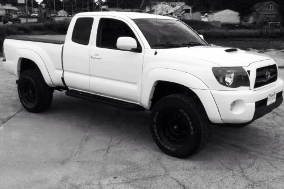

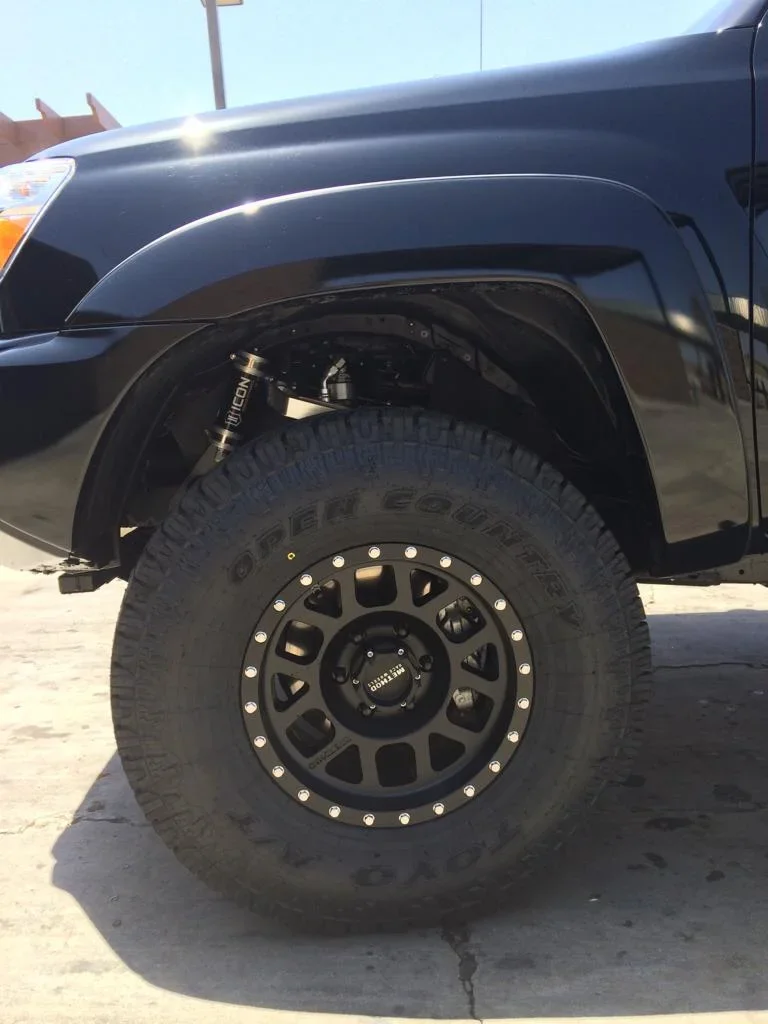

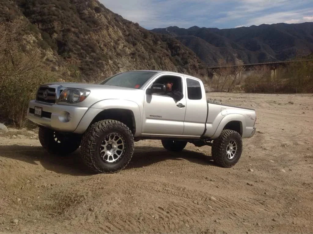

2014 TRD, Stage 4 Icon Suspension, Toyo 33 A/T, Method Mesh 16inch Wheels, Apex 30" LED light bar

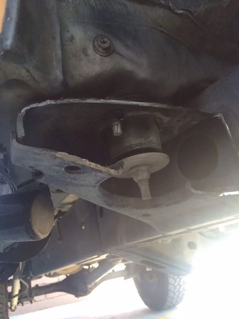

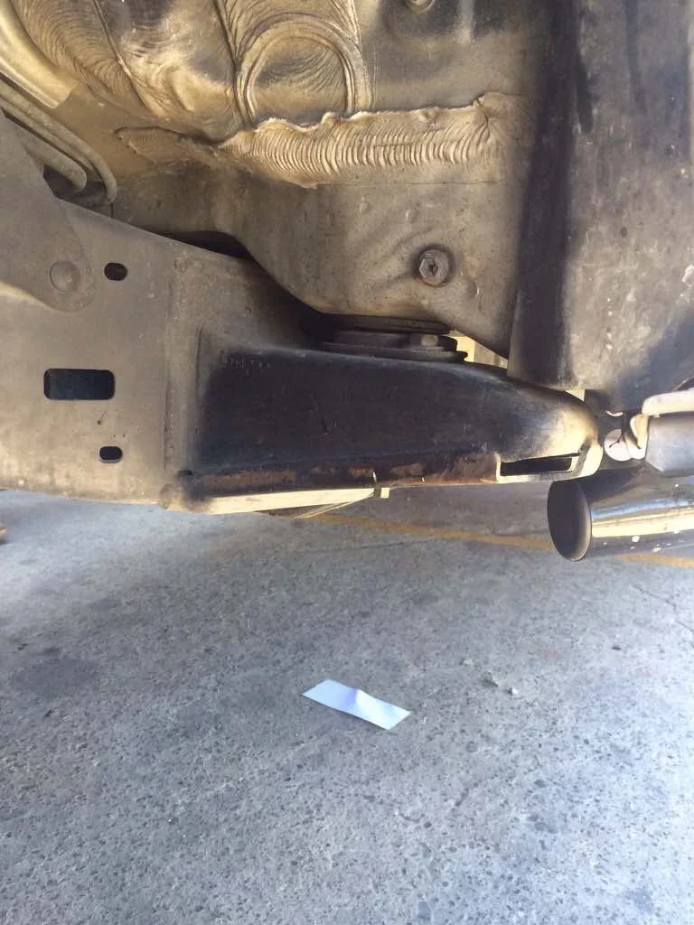

I have a 6.5" MaxTrac spindle lift and my 34.5" tires rub when wheel travels upward during a turn. It's my wheels though. -12mm offset. Plus the spindle kicks the wheel out an additional 3/4". So the wheels stick out pretty far. I like the look, don't like the rubbing. Gotta cut a little more of the plastics. ImageUploadedByTaco Forum1412265935.694771.jpg

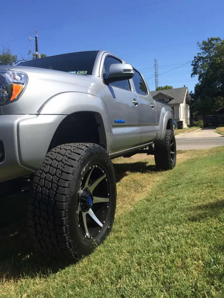

Yep, I also have a 6" BDS lift and running some nitto's 34.5" tires an they rub when I fully turn, so I had to do some trimming on the cab mounts, now is ok, unless I'm doing some bouncing off-roading ImageUploadedByTaco Forum1413702047.327278.jpgImageUploadedByTaco Forum1413702081.996085.jpgImageUploadedByTaco Forum1413702115.659730.jpgImageUploadedByTaco Forum1413702178.730141.jpg
Haha, C'mon guys, he's 1st gen for one thing , no cab mounts to chop & OP you could go to 4" in front (with drop bracket, not recommended tho') beat down all the pinch welds & I'm betting you'll still rub in a turn off roading & yeah, wait till you SAS ... IFS sucks ....
