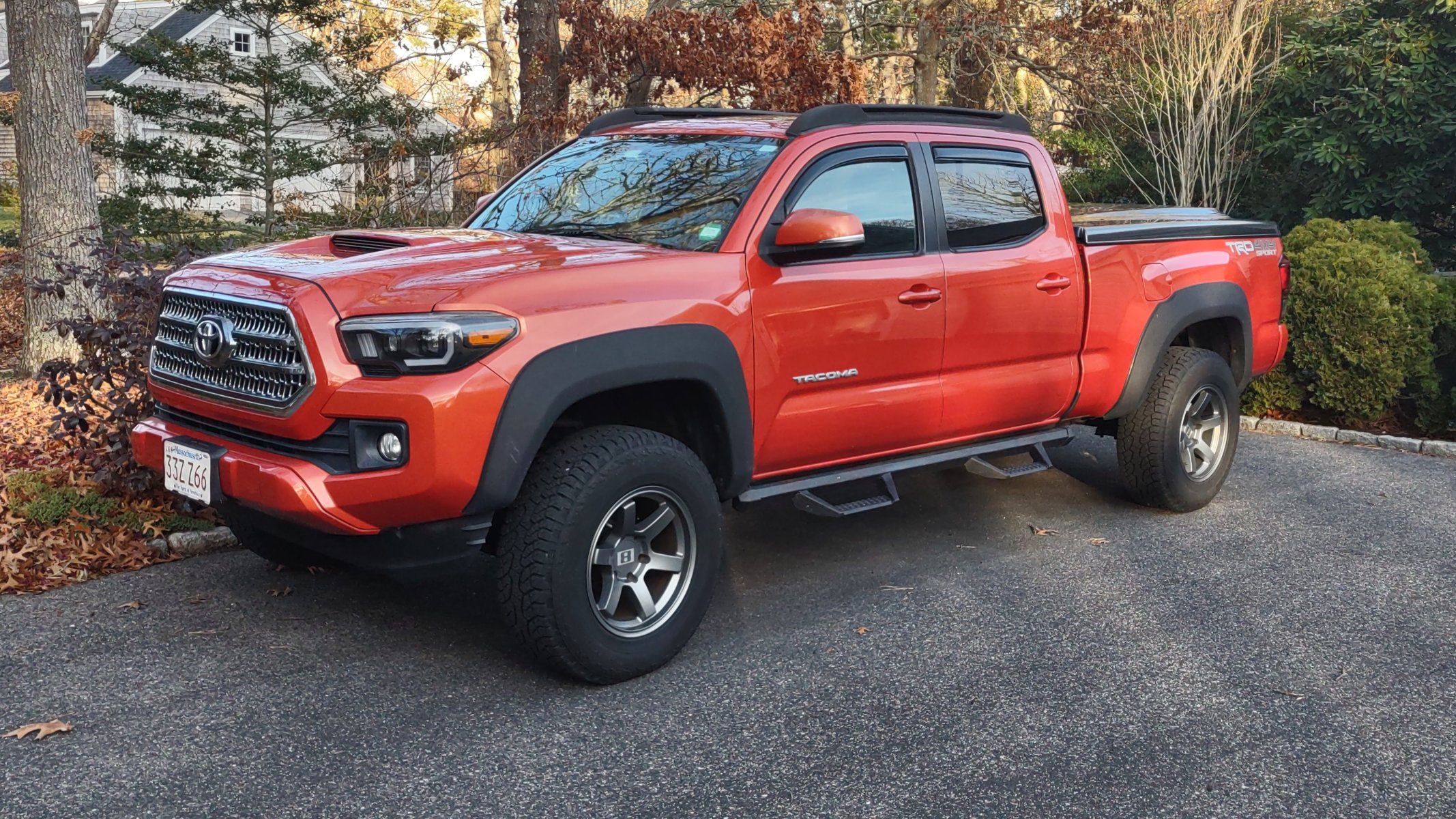

I have 265-70-17 hankooks very happy with them on 9 inch x 17 -12 offset 4.5 backspace . They rub a little so I lifted 1.5" all around .& 1.25 spacers IMG_20241127_151059369.jpg
The KOs are a bit chunky .rims are Level 8 I like them but I think the 8s would not have rubbed with 0 offset . Good luck

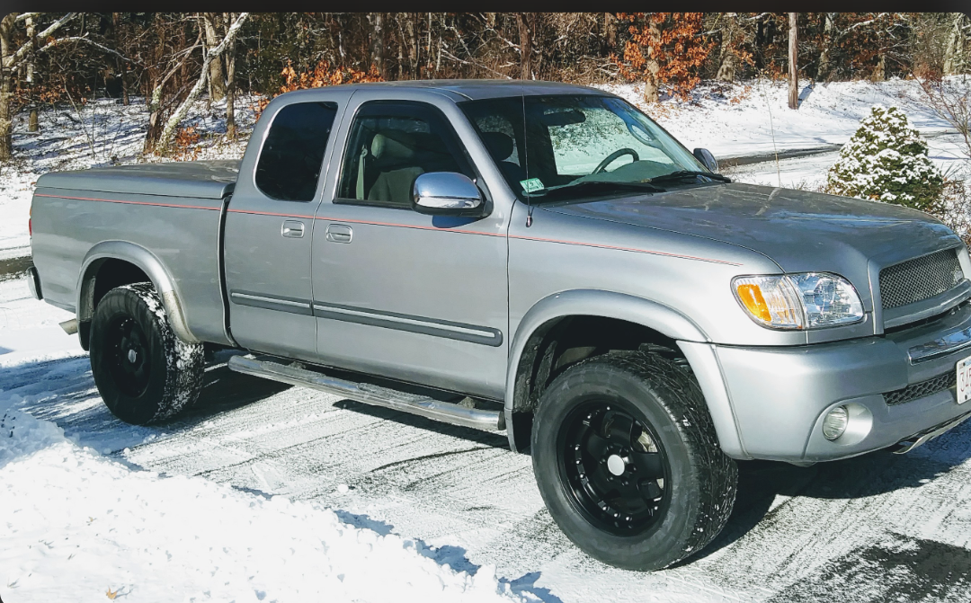

It's funny when I bought the Tacoma I put my 18 x 8.5 Moda wheels off my 03 tundra on the Tacoma they were 0 offset 4.5 backspace,and I had 285-60r-18 kuhmo exstas on them and no rub no lift ,weird ?Screenshot_20230625-063040~2.png
It's funny when I bought the Tacoma I put my 18.5 x 8 Moda wheels off my 03 tundra on the Tacoma they were 0 offset 4.5 backspace,and I had 285-60r-18 kuhmo exstas on them and no rub no lift ,weird ?View attachment 47632
Not really, stock the gen1 tundra was even larger, and taller than theses gen3 tacoma's. Wasn't hard to put a larger tire with no issues, plus you had big torque from that 4.7 v8, especially in later year gen1 trucks like yours.

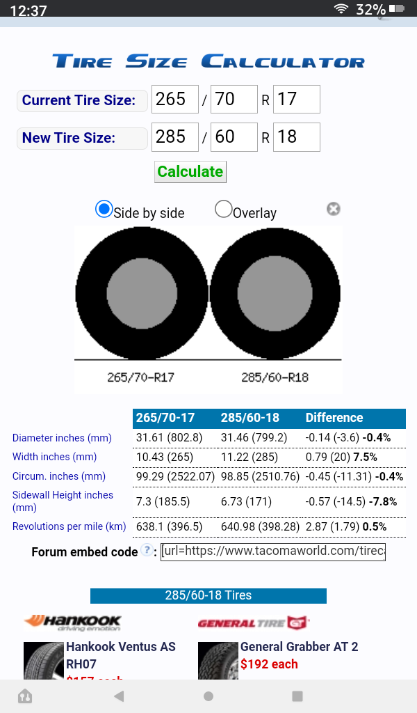

No I meant the tundra wheels fit perfect on the Taco with no issues that was weird ,and they are about same height as the 265-70-17s and the tundra had 285-60-18 s.they were a bit wider
Ya but the smaller 265-70-17 on my Tacoma were smaller and they rubbed so I had to lift it . The 18s were tested on it before the lift and had no issues. Smelling what I'm stepping in ?
