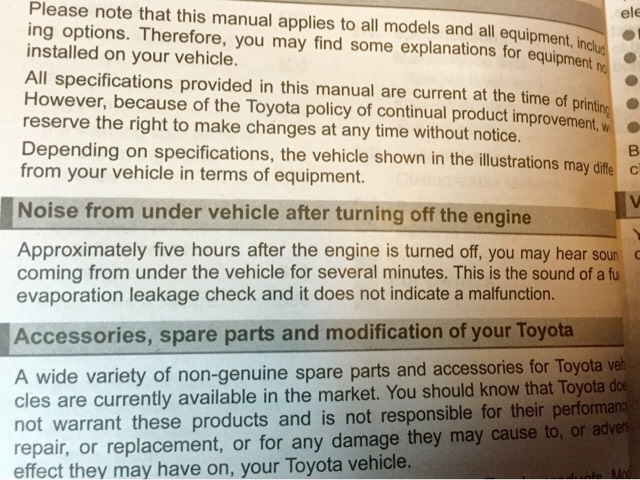

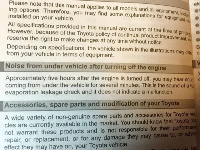

I have a 16 Limited (love the truck!) but a couple times now after driving it and parking in the garage there is a steady electrical humming sound. It almost sounds like the fuel pump running. After much investigation listening under the truck, questioning what we could have done and deciding that it's not a normal sound we've heard before. My wife decided to pull out the manual and one of the first things listed is this.
Hope this helps someone else not to think they are going crazy!
