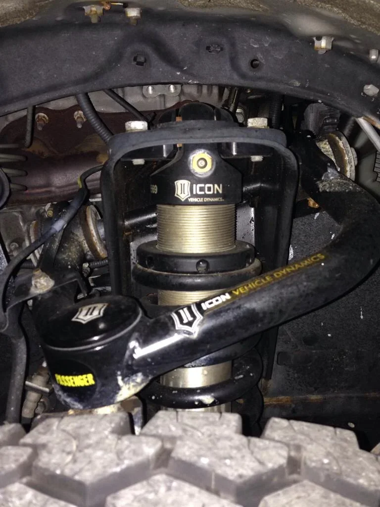

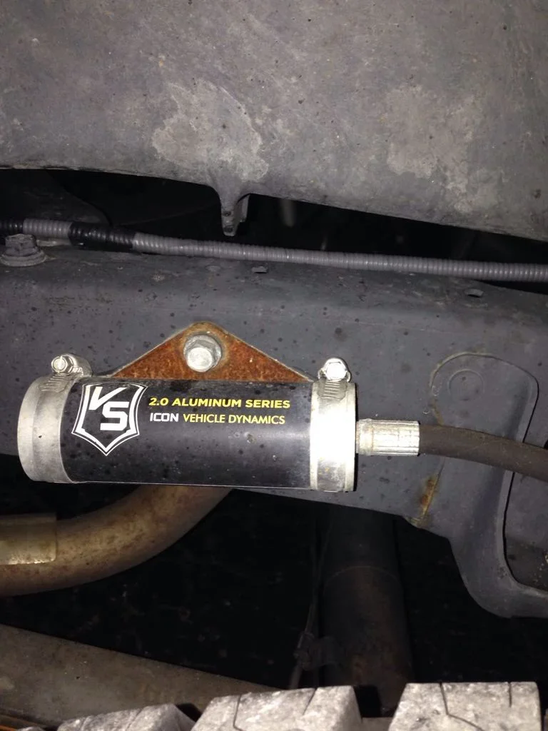

Im new to the Tacoma world and dont know much about suspension lifts. I bought 2010 tacoma TRD sport double cab with a Icon Vehicle dynamics suspension lift. I bought it from a dealership after trading in my vehicle. I got an amazing deal on both ends but the salesman knew Zero about the lift. Just wanna get some feedback also wondering what the biggest size tire i put on. Right now it has 265/70/r17 with the stock rims. Thanks for your help! ImageUploadedByTaco Forum1409976151.723072.jpgImageUploadedByTaco Forum1409976197.207809.jpg
Thank you. Any type of spacers or anything i can add to the rear now and keep these shocks? Can a leveling kit be added?
I'm going to say no. The rear shocks aren't designed for a 3 inch lift so you will over extend them. You can contact Downsouth Motorsports for more info and advice. They can even build you the same shocks with extended shafts so they are good for a 3 inch lift.
