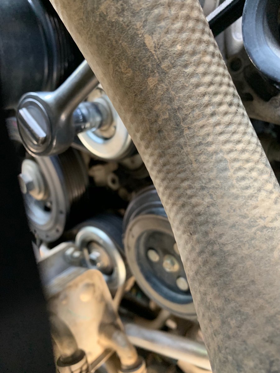

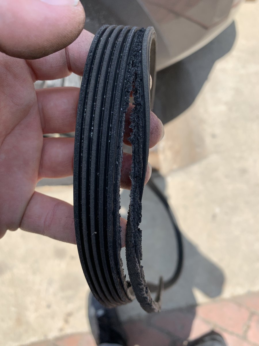

Idler pulley Wobble
The contact surface of the pully has no runout. The face of the pully doesn't matter in terms of it's operation.
There is no movement on the contact surface with the belt. When the pulley was stamped, the rounded edge on the front wasn't perfectly perpendicular with the pulley belt surface.
If there was movement between the belt and the pully, then you would have heat. The bearing in the idler will get warm from engine heat and from internal friction in the bearing. If it fails under warranty, the dealer will replace it.
