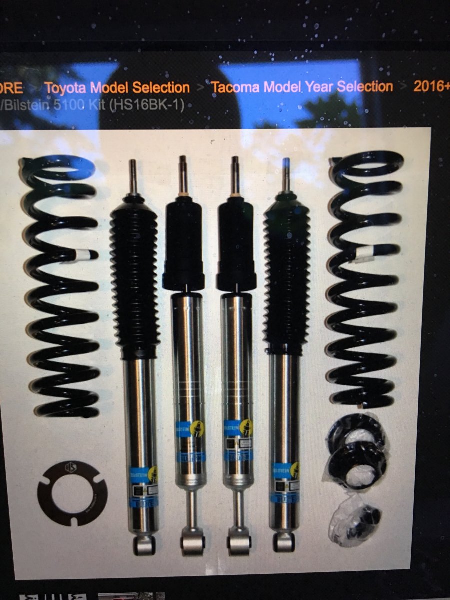

Hah. Sorry I went back and forth so much AAL/progressive that I forgot what I ordered. I order 5100 with OME 887. Deaver single leaf. Basically the package from HeadStrong.
IMG_1532628249.188054.jpg here you go. The leaf is not in the pic. But it’s a single. It’s on the way. Don’t have it in possession yet. I am leaning toward doing it myself. I’m sure it will be frustrating (at times) but I will learn a lot.
