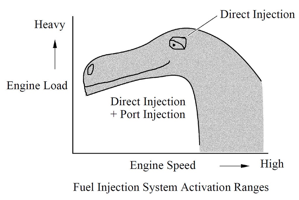

I think the problem there was lack of port injection. The 3.5 in the Taco had port and direct injection. There should be no oil vapor buildup in the intake tract.
