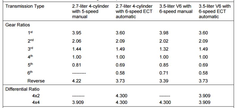

The downshift going up an incline I believe is due to the low gearing for 6th gear.....it's not a 1:1 ratio.........more like a .58:1 and the engine isn't pulling enough RPMs to keep up so the downshift occurs. 5th Gear is a little better. Mine does the same thing but is better after the TSB update done but still does it. 6th gear is the overdrive......when driving around town I keep mine in "D"......I've used Sport Mode a couple times. ECT button doesn't really give you more power.....just changes the shift points. Here's a link to just one of the threads here on this.....http://www.tacomaforum.com/threads/transmission-update-for-2017.8544/
Here's a pic of the gear ratios for the 2016-2019 Tacos that shows 6th gear is really low which would cause the downshift on inclines.
The 6 speed is basically a 4 speed + a double overdrive. The high gearing of 6th gear is strictly for gas mileage while cruising flat and level, pretty much any load will kick it out if 6th gear so as to get some pulling power. If we had a big v8 under the hood with lots of hp and torque it would be less likely to be down shifting all the time. The little van I drive at work has a 4 banger with a 9 speed and it is constantly changeing gears.

Regear to 4.88 [emoji4] and you will be satisfied, thats what happens when toyota puts a van engine in a truck[emoji44]
This... the little 3.5's don't have enough gumption to pull the truck with any load in 6th gear... especially with the factory tune and automatic transmission...
My tuned manual will climb some impressive hills with cruise on in 6th and only loose a couple mph's... but my 6th is a smidge lower than the autos 5th and I have a .4 lower axle ratio... haha
