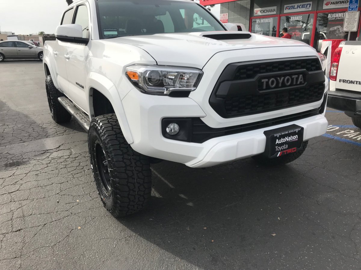

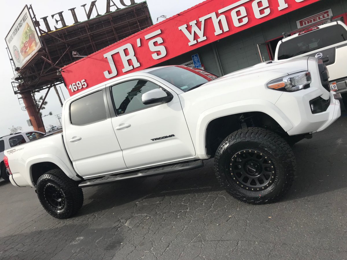

It does sit pretty. I love the white and black. Now time to enjoy it.Maxtrac 4 inch spindle kit 2” rear block with rear Maxtrac shocks
Falken Wildpeak 285/70r17
Method Grid 17”

Prerunner Baja stance.Why the front wheels stick out so far?
Method Grid 17”
Somehow I missed the word spindle . LolPrerunner Baja stance.

You can if you’re a prerunner... 2wd.Forgive my noobiness, being this is my first truck, what are spindles and what do they do? Will I get that stance? That's amazing and it seems like a cheaper route from going the dreadfull long travel kit.
My biggest reason for wanting an LT is because I wanna throw McNeil racing 3x2 flares, in one of his pics it looked like his front wheels stuck out further. Is that also done by spindles or were spacers involved?The spindle holds the hub for the wheel and is connected to the UCA and LCA.
This kit is great man but it’s overlooked because most people seem to lift 4x4s which makes sense. these kits are 2WD only
I wouldn’t use wheel spacers, get a lower offset wheel.My biggest reason for wanting an LT is because I wanna throw McNeil racing 3x2 flares, in one of his pics it looked like his front wheels stuck out further. Is that also done by spindles or were spacers involved?
