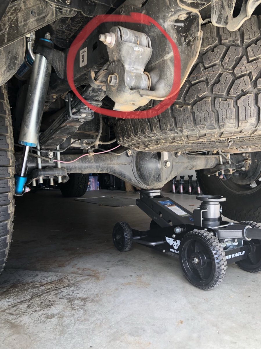

What are you guys using to prevent or minimize the squeaking from the leaf springs. Sprayer some of the uniball cleaners but don’t think it was enough
Mine is starting to get annoying. Lol you can hear me squeaking up the street. I used some dry ptfe lube that I had for cleaning the uniball in uca’s maybe I didn’t hit it with enough.
You got to open them up. Jack the truck up so the axel drops and they open up.
From the previous thread it seems like people were washing between the leaf springs. I might have to do this as it seemed pretty muddy/dusty all up in there
I put the truck on some 6 ton jack stands at the frame so the suspension drooped... Used a prybar gently, and a long skinny knife... I know, it's an old pos and about as thin as 3 sheets of paper. Slid Marine grease between all leaves.
Been years, not a squeak.

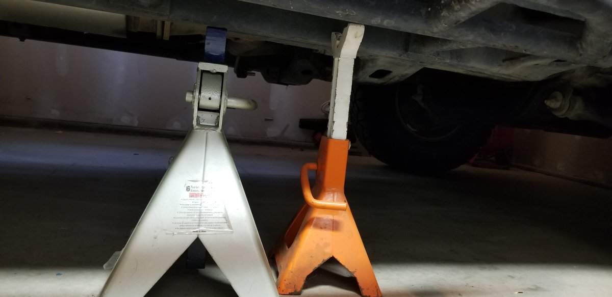

6ton are MUCH taller.
2 ton wont even touch the frame fully extended with the truck sitting static.
6 ton CLOSED are as tall as fully extended 2 tons almost
Full extension on 2 ton... Barely any frame contact with truck sitting static, the tires won't come off the ground with the 2 tons on frame.
That 6 ton is fully closed

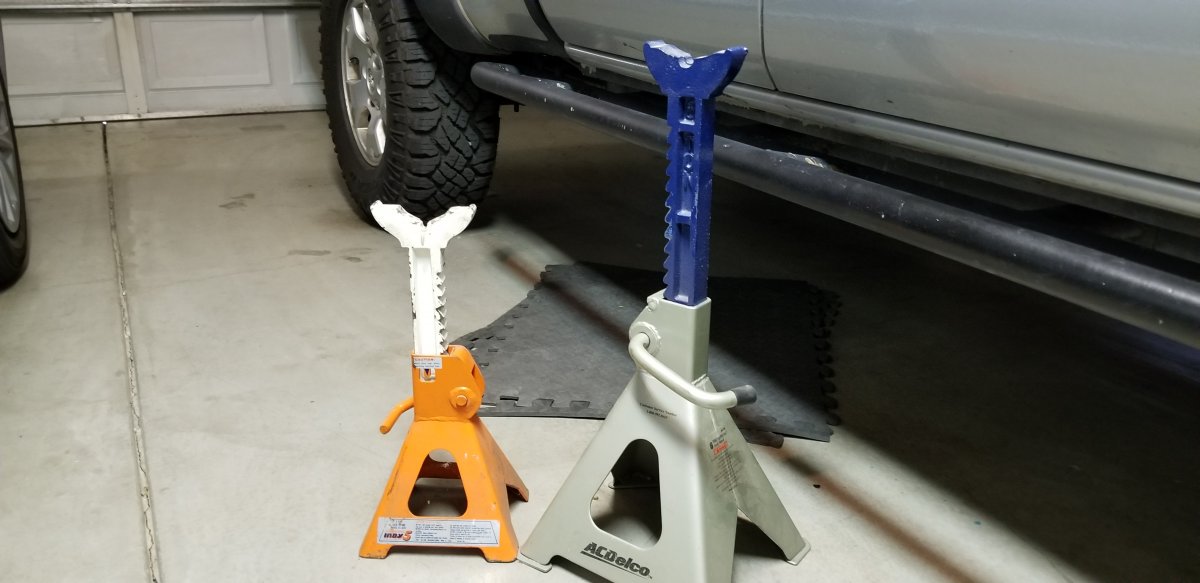

Here's side by side extended
I love the wider footprint and better build as well for the truck.
I honestly didn’t know there was that much difference. Thanks jangles
Dang that’s a big difference. My squeaking is better but still notice it at times. I must get deeper
Yeah I about **** when I went to lift the truck and have the suspension droop for the 1st time. Damn 2 tons were fully extended and when I lowered the floor jack the stands made contact with the frame but the damn tires were not off the ground.
