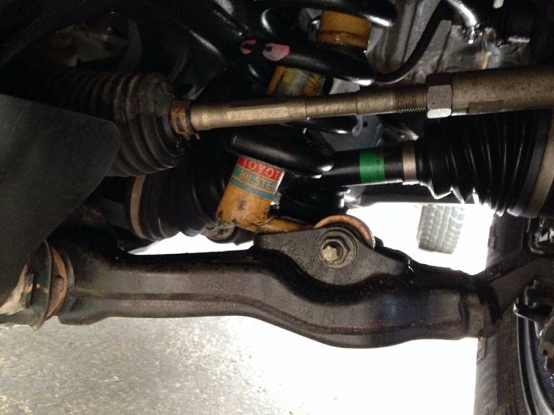

I did the revtek pro 40013 it’s an in-coil spacer up front and and AAL in back. I had the bilstein 4600’s on the 2017 off road. It made the ride worse but gave me the lift to add the tires I wanted. It did ok off-road but did limited my up travel. If I was going to do it again I’d at least get the 5100’s and an AAL in back. It would have been about $200 more and would have been a much better ride for DD. Live and learn.

Just use your head for now, the last thing you wanna do is bottom out the front end in anyway. Your sacrificial part used to be your bumpstops, but now it's your shocks.

From there I went to the Toytec adjustable coilovers. Bilstein 5100's seem to be a popular lower cost option that would prevent this. Old Man Emu has a good looking kit for ~$1,200 ish I think? I liked Toytec products enough to put them on 3 Tacomas if that tells you anything...
I also run my trucks harder on a weekly basis than most people ever do in a lifetime... just because you put a cheap spacer lift on your truck doesn't mean that this will happen at the next speed bump... but I wasn't doing anything out of hand when this happened. Thankfully, my new coilovers were laying in the garage and I was actually seeing what it would take to make this happen just a couple miles from home. It happened a good bit earlier than I expected... haha
The main reason we recommend against spacer lifts, or at least me, is because the ride is just terrible compared to what you could get for a couple extra hunnits and you can actually increase the amount of travel in your suspension with better kits. Whatever you decide to do, be sure that your bump stops are correct.
