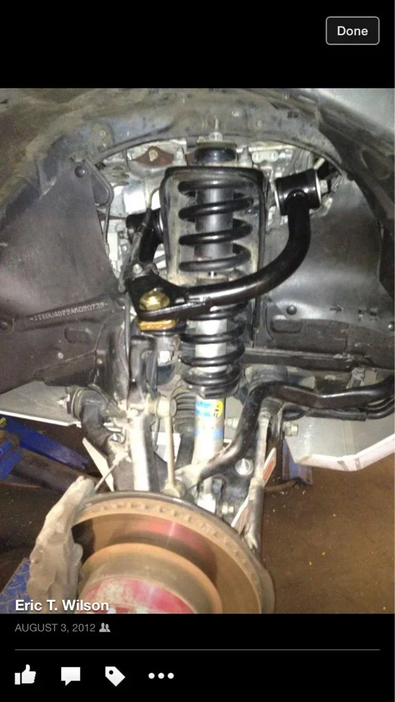

Sure, I also use Light Racing UCA's I like the adjustability of the ball joint nut.ImageUploadedByTaco Forum1420376832.867401.jpg
