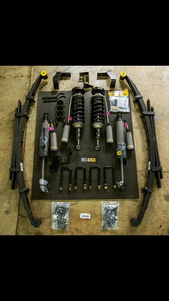

Really depends on your budget and wants from this kit. You can use the stock size tires with the OME kit but it would visually look better if you step it up a tad to 265/75/16 or 265/70/17 (depending on your wheel size) just to give you a bit more tire. Some want to go larger than that but then you run into rubbing issues.

The bilstein 5100’s are adjustable so you can set it at 1 or 2 with the stock wheels and tires and it’s going to give you that little extra lift without looking to bad. Old man emu kits are really good but not adjustable they will give the gen3 a 2-2.5” lift in most cases.
If you start with just 5100’s now than later when you add the bumpers get a higher rated coil. OME 886 will help set the 5100’s to 0 or 1 and you should get about 2.5” of lift. Put some Dakars in the back with 5100’s and it’s not going to break your bank and you can do it in stages.

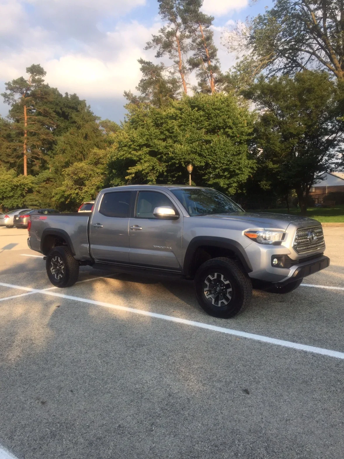

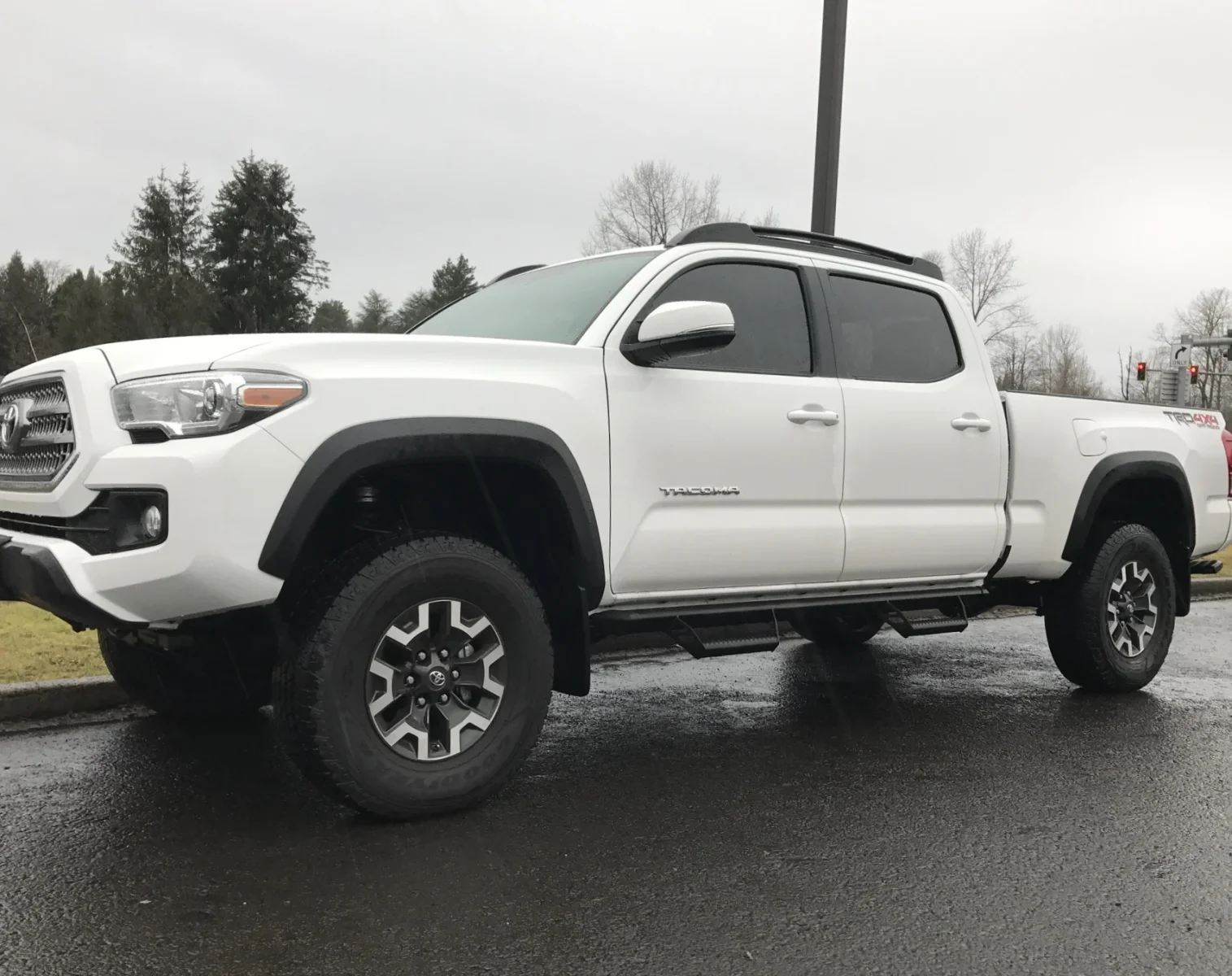

You could put a 3” lift on and still utilize the stock tires. It’s not going to look right IMO.
3” lift with stock tires/wheels: 6896C281-9F43-4BCC-AB57-1DC99112B560.jpeg
