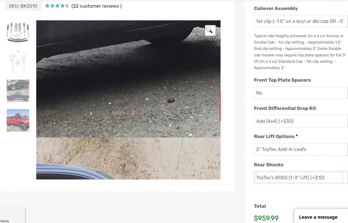

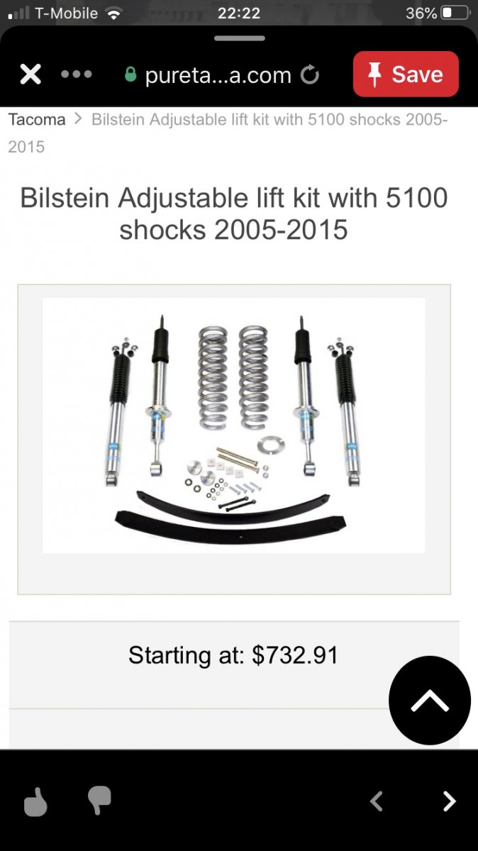

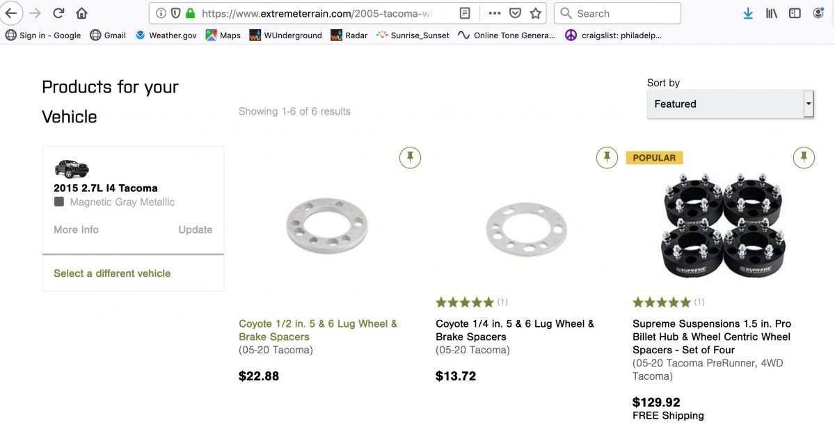

I'm in the process of lifting my '15 Tacoma, 2.7L 4WD, man trans, extended cab. I have been in contact w/Bilstein Lifts support and they have been helpful. Certain 2015's, according to Bil. Lifts, aren't all exactly the same on the "inside". They make it clear on their site, certain rear shock choices do not fit as expected. I attached a screenshot showing their recommended "no hassle" kit for a 3" sus lift for my truck. (for light off-roading, not racing around @ hi speed on rough terrain.) I plan to keep my Toy OEM 16" x 7" steelers; just gonna paint them black. I have searched for specs on Toy factory wheels, and no results I've found so far indicate what the backspacing is on these wheels. So if I were to buy spacers, if they're even needed, I need that info to do the math.
