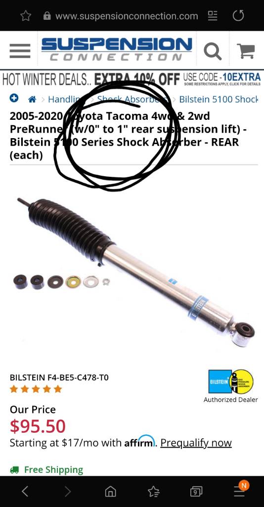

Looking to add 2” of height so I don’t have to upgrade control arms etc. I was looking at the kit from headstrong. Was going to probably do it myself. I’m assuming shops charge outrageous amounts and nothing should be seized it’s got 29k miles 17 limited.
5100’s all zero
887 springs
Do I want a Deaver single or hs 3 leaf aal?
Also I’m assuming I need to take it to the shop to change out the needle bearing?
Looks like it’s about 800 or so bucks from headstrong, would it be cheaper to source from multiple companies?
Would this all I need to do to the truck itself to not have damage?
TIA

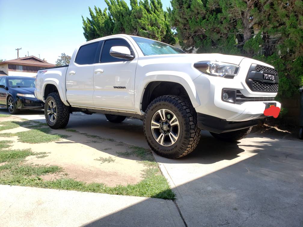

My truck
Bilstein 5100 max height setting in front 2.75inch
Rear at one inch with shocks plus I added a leaf, to make a 2inch lift.
My tires are duratracs 265/70/17
No rubber or vibration, had everything done at my dealership. Everything else on my suspension is stock.20200113_021616.jpeg
