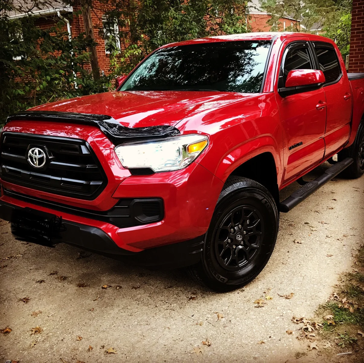

Looks like a good kit. It will be way better than what you have on there nowSince the subject is lifts, I have a 16 TRD Sport 4X4. What do y'all think about this?
https://www.allprooffroad.com/shop/all-pro-sport-suspension-kit-with-bilstein-shocks/

These trucks are best at 2.5-3”.
