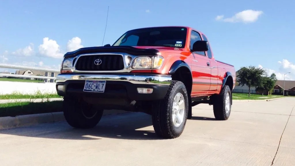

I got a 2001 Tacoma with 31 inch tires, 265/75/17 with a 3 inch spacer lift. I had to buy 1.25 inch wheel spacers so they don't rub. But yes they will run without wheel spacers only at full turn.
