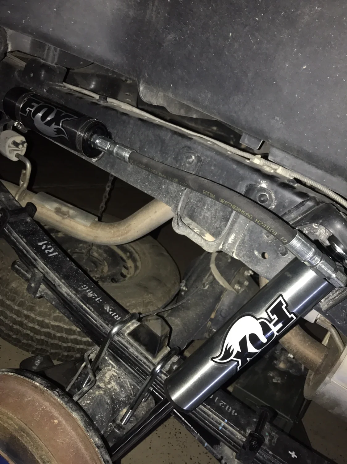

Lifting my taco and it rubs
rosemeadblvd
2017 TRD Off-road DCSB. Here are the mods.
1. Mickey Thompson MTZ p3 285/75/16
2. Fox 2.5 reservoir front And back
3. ICON AAL 51100
4. ICON UCA
5. Diff drop kit
The rear gives me around 7 CM like around 3"
The front gives me only around 3CM like around 1.25" lift. This is the original fox shocks height when they came in. I have the stock TRD Off-road plus spidertrax 1.25" spacer on them. Alignment has already done.
There are 2 places rubbing. Please refer to the photos. The first one is the rubbing photo the rest just for fun.

You’ll need about 1.25 more inches of lift in the front. Then it will only rub when turning and hitting a bump.
If that is the case do you recommend to go back down size? I want to be able offroading with 286/75/16
Lots for us have 285/75/16 with 2.5-3” lifts and take our trucks off road. I rarely get rubbing and have a 3” lift. Lift it as high as you can and get an alignment shop or off road shop to align it.
Camber as close to 0 as possible
Toe as close to 0 as possible
Caster 2.5 or higher.
If the person doing the alignment is good it will help decrease rubbing.
