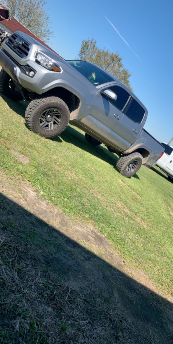

I currently have a black widow 250 race Venom muffler I’m wanting to install but wondering what would be the best sounding muffler? Should I put bigger piping? I have a air raid throttle body spacer and cold air intake. Please help me? View attachment 27896
