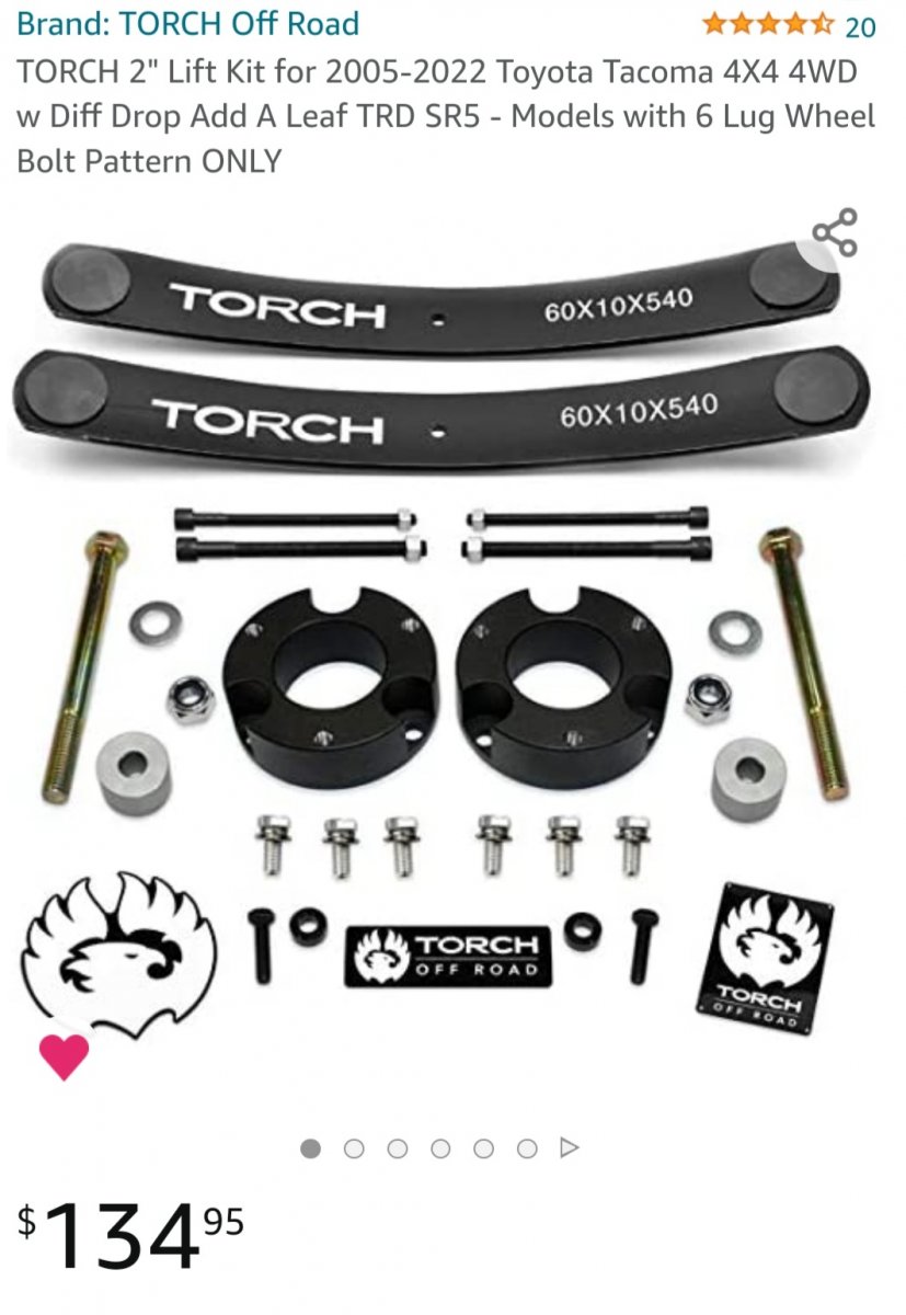

I looked through what they had on their site, and I think I made up my mind. I'm interested in this.
Also, the only other thing I would need is a diff drop kit, right?
